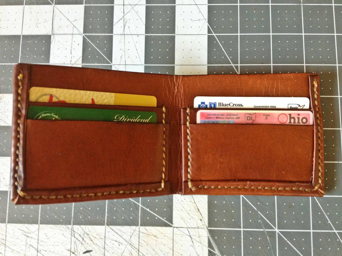

Members Hi Im Joe Posted May 6, 2014 Members Report Posted May 6, 2014 Hello all, Here are a couple wallets I've done and a portfolio I did for someone from Reddit. She wanted a portfolio to give to her boyfriend in the army corp of engineers. So I've never made one before so I told her I'd make her one for my cost of materials plus shipping. I think it came out pretty good. The wallets I tried to turned turned bindings for the first time. It was a great learning process. The chromexcel card wallet has cut edges on the turned binding (was just trying to figure out the basics). The veg tan medium brown wallet has the bindings folded on themselves and then folded over the edge. It was a bit of a challenge. Please tear them up. Let me know how I can improve. My feelings will not be hurt. I learned that you have to leave some extra room between the binding and the edge you are turning it over. I also learned that cutting the corners is hard. I need to improve in that area. Thanks for looking! Joe Quote http://www.sevenhillsleather.com/
Members Narvi Posted May 6, 2014 Members Report Posted May 6, 2014 I like them. It's not easy to do a turned edge binding on a wallet, so good job. I think the wallets would benefit from smaller thread. Royalwood and Maine Thread are good suppliers. Quote
Members Hi Im Joe Posted May 6, 2014 Author Members Report Posted May 6, 2014 On 5/6/2014 at 2:47 PM, Narvi said: I like them. It's not easy to do a turned edge binding on a wallet, so good job. I think the wallets would benefit from smaller thread. Royalwood and Maine Thread are good suppliers. Thanks! Yeah the chromexcel wallet is using tandy's tejas thread which is freaking giant. The brown wallet I wanted to see how artificial sinew worked so I used that. I have a small amount of tiger thread coming which I"m going to try out and if I like it I'll buy a bunch. Thanks for posting the suppliers I'll check them out for sure! Quote http://www.sevenhillsleather.com/
