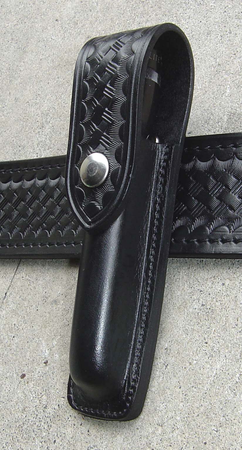

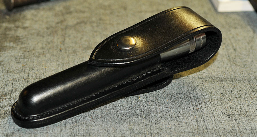

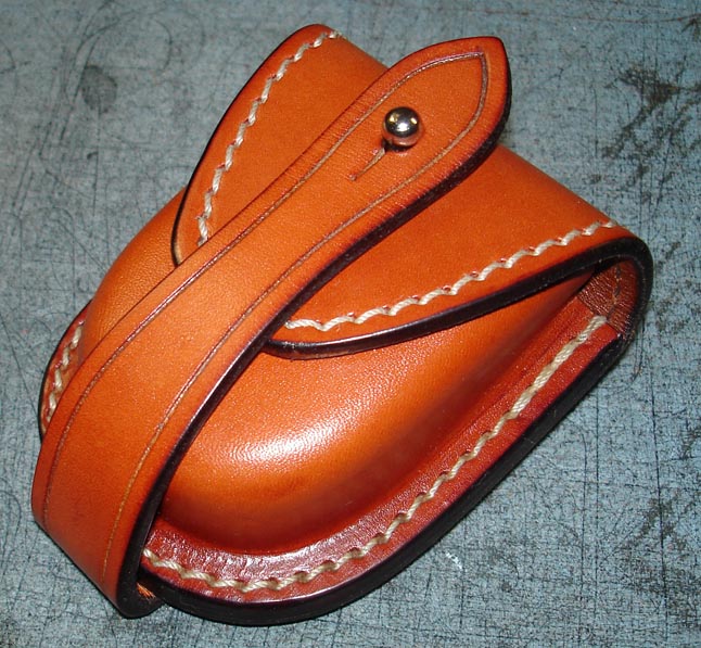

Members Trevor Posted June 18, 2014 Members Report Posted June 18, 2014 Hi there Minimal. I do and have done a lot of molding and this method looks hard and is very impractical. I have always used the wood pattern over block way of doing it and have had great success with this. Here are some of the finished items that were made with wood. Cheers Trevor "Way Down Under" Quote "Every Day Above Ground Is Good"

Members Trevor Posted June 19, 2014 Members Report Posted June 19, 2014 Thanks Bob. To me the whole idea of making a molded pouch means to stretch the leather over a shape to get the desired result. These pouches are simple and can be made easily with some wood and a few bits and pieces. I used to use a large vice to squash it all together but I now have a proper press. But the vice is still ok. Using anything soft or semi soft would not allow the leather to stretch properly Cheers Trevor Quote "Every Day Above Ground Is Good"
