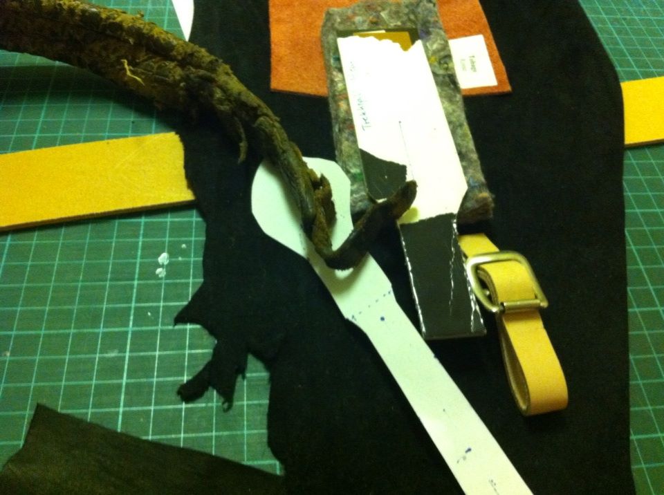

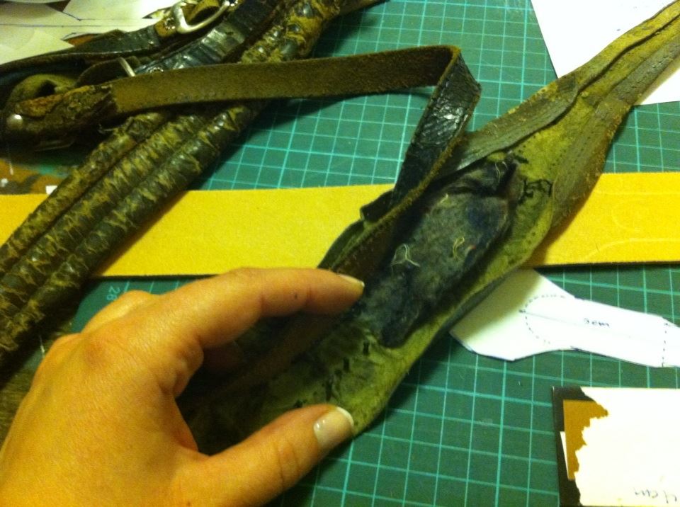

Hello! My dad want me to make him new accordion straps, sinse his 50year old straps are totally broken. Okey I said, and ordered two belt blanks 4cm x 130 cm , and some thin reindeer lining, and cotton wool, because thats what was originally inside the old straps (dont know about the padded leather, only it's thin and stiff). The reindeer lining is thin and super stretchy, skeptic it will work...

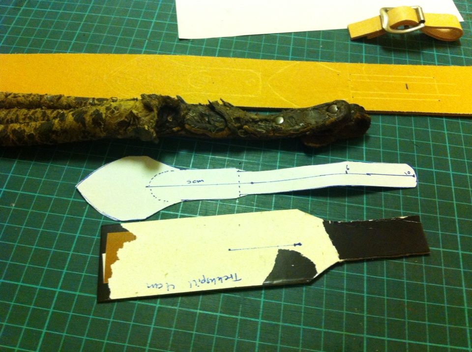

Anyway, help, please! I want to reinforse the strap ends whit shields, so I make templates/pattern, and new 4cm straps is double wide than old, so I will have to narrow down at ends, -dad want me to use the original buckels. OK, always measure and make templates, so I am doing that, but oh my this is stressing me ;)

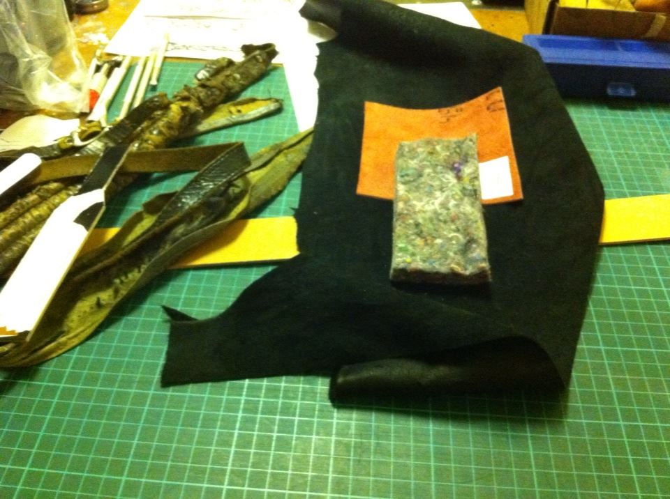

What would you do? Any tips and pointers? Please look at pictures attatched. On small straps, it's filled with some fabric (?) And all ends have some reinforsing inside looking like cardboard!

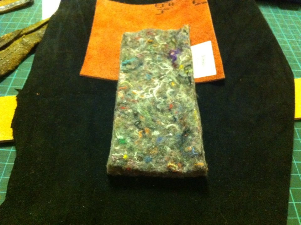

My big consern is the padding, how to get that correct..

The cardboard papery stuff is just a filler. No strength so thicker leather can look after that. And like you have found, the ends need to be skived to reduce their thickness a little. Dampen the bends before you bend them.
If you are using vegetable tanned leather, and thicker leather, you don't need to fold the edges of the leather over like the originals. The edges should be beveled with an edge beveller and then you can burnish them. See http://leatherworker.net/forum/index.php?showtopic=18101&hl=+burnish%20+hidepounder&page=1 for how to.

I have added "padding" on the small strap too, used some thick suede leather (?) inside the deerskin. Been searching around here on leatherworker, and one tip about using doublesided tape for holding together was awsome!

I am not sure where you are with your project. I would have considered a veg tan main strap. The filler you chose would have worked for me as well. For the under strap, I would have considered thin veg tan or chrome tan with thinned veg tan glued to the underside. Your replacement strap looks really nice!
