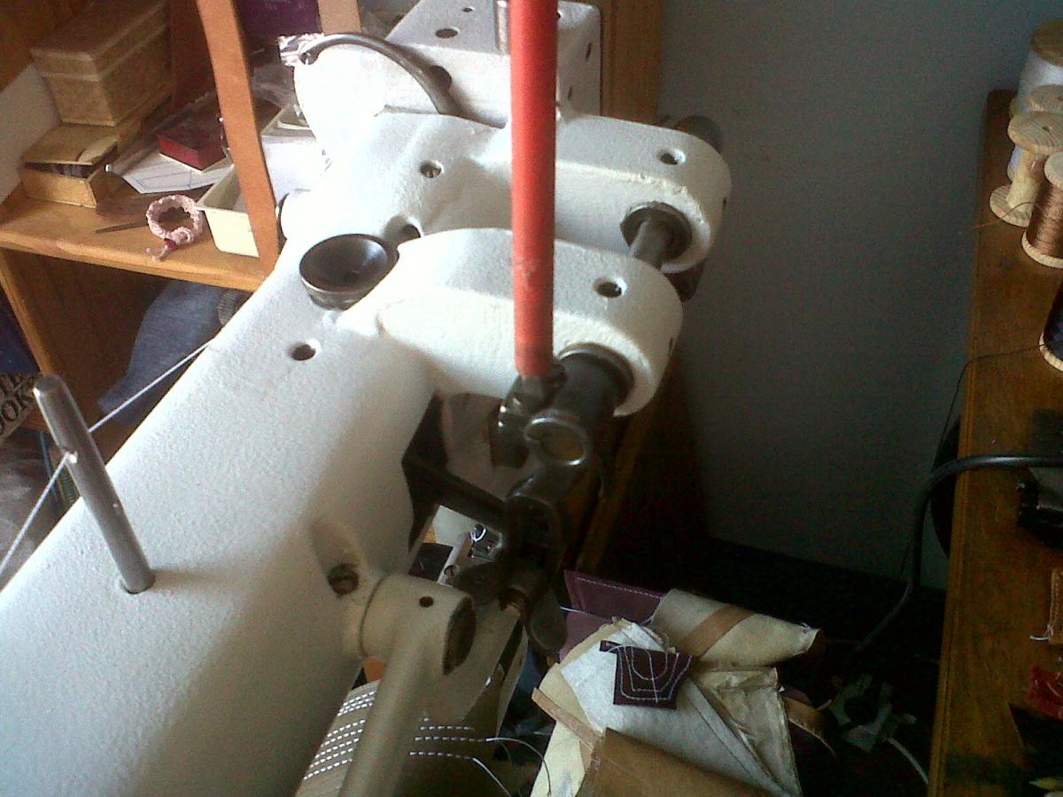

I will take a few pictures and post then about the walking foot not being down.
Ok look at the second picture thats as far down as the rear foot comes down. its ok for thicker material but not two layers of sunbrella. I looked in the pdf 335 manual but trying to figger how to lower the rear foot looks dificult.
Maby its set up for that raised lower plate and smooth dog ?

Just to add my machine is a 335 H3 the next set of numbers are 17/01 BLN any help or advise would be great eh ?
Just trying to figger out why the rear presser foot dont come down right to the feed dogs is that normal ? see pics ^

Turning the hand wheel while the screw is undone wii reposition the crank, when u retighten the screw it will be in a different position. I had to experiment a bit. I am currently away from home on holidays so cant post a picture. I agree about going slow and cautious about adjustments. Brad

Hi Dingus, did you manage to adjust your presser foot height? i have just stripped one down and put it back together and it sews so i could maybe show you where i adjusted it.regards jimi
no i have not adjusted its height can you explain how you did it please ?
Hi Dingus, what i did was loosened the two screws on the right hand side of the back rod at the top to take out the bushings to clean them and putting them back is when i adjusted the back presser foot with the front one. because the back foot was only lifting up about 1mm or so. thats the rod that is connected to your presser feet, it has a winged nut on the right hand side. so before you loosen make some kind of mark so as you can get back to the same place as before. i loosened the screws then turned the balance wheel until the front foot was halfway up then pushed the back foot to the same hight and then tightened the screws again. now the back foot and front lift even.i dont know if that is the correct way to adjust it but seeing as i had it all dismantled i had no option. in that adjustment manual of the new ones it is screw 4. by the way i cant get mine to lift 7mm like it says in that manual??
I see the two screws way over on the right near the big wing nut is them the two you loosened or is it the two over to the left about 4 inchs ?

Oh, sorry dingus i didnt see your reply. i loosened the ones near the wing nut but it dosent matter if you loosen the ones on theother side because it is on the same rod.

Most 335 machines have around 15 mm of foot lift. And can sew 6mm thick any thicker and they don't feed due to the walking feet only raise so far while lowered in to sewing position or that's what the spec. On the Yamata fy335a that's what I have I got mine for lighter weight leather . Like wallets and hand bags.  I use a Tipman boss for holsters it will sew 3/4 inch thick leather but it's manual not powered by electric.  There are machines that will sew heavy-duty items but they are pricey. Cobra makes a nice machine for holsters that's electric. I'm new to the 335 myself but have done leather work for 30 years.
You do realise you have responded to a 10 year old post? As for the 15mm lift, the post is referring to the old casting 335 and I can assure you it doesn't have 15mm lift.

Is there a difference between the old and new boxy looking 335 in foot lift? I always just assumed it was the same machine more or less, just bloated and boxy w/bobbin winder to look more modern and sophisticated.

The "newer" models have better foot lift/clearance than the older ones, probably a more useful machine overall.....but the old ones have character! (I have to say that 'cos I have one :rolleyes:).

The H2 had 7mm of lift, earlier H3 was 11mm lift,    H4 and white 335 pfaff have 14mm lift.  Your 17/01 is a binder 335.  Need pics of the machine.
