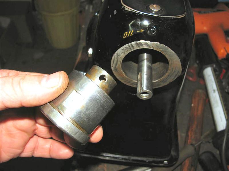

Members patches Posted July 29, 2014 Author Members Report Posted July 29, 2014 Well, my timing belt is here. I have marked everything and removed the hand wheel. I loosened the two set screws on the inside of the machine nearest the wall of the machine. Sooooo now I am stuck. When you say bushing would that be the large round piece which appears to house some ball bearings? If so should I use a small flat punch to gently drive it out. Sorry for all the questions but the owners manual I have is not very clear about this. Quote
Members Constabulary Posted July 29, 2014 Members Report Posted July 29, 2014 (edited) Yes that is the bushing. It may sit very tight in there. Only tap on the outside and not on the part that was secured on the upper shaft. I have attached a picture from my restoration Edited July 29, 2014 by Constabulary Quote ~ Keep "OLD CAST IRON" alive - it´s worth it ~ Machines in use: - Singer 111G156 - Singer 307G2 - Singer 29K71 - Singer 212G141 - Singer 45D91 - Singer 132K6 - Singer 108W20 - Singer 51WSV2 - Singer 143W2
Members patches Posted August 6, 2014 Author Members Report Posted August 6, 2014 Got it. Thank you so much. It is sewing beautiful and my stitch length adjustment is working. Now I am going to start on my singer 294. Wish me luck :-) Quote

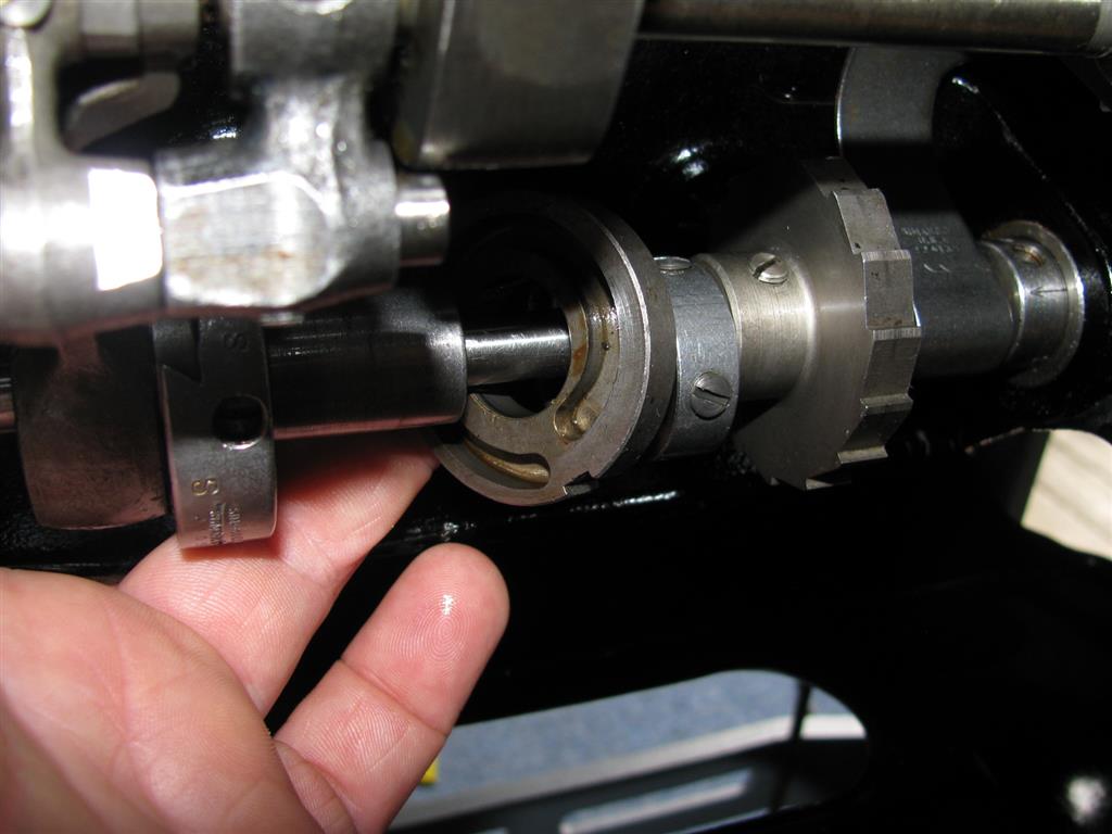

Members AluminumAcres Posted July 15, 2015 Members Report Posted July 15, 2015 Great thread, I am slowly learning my machine. I am also having problems with my stitch length setting. My first question, what components of the lower assembly should move when the button is engaged? I turn my hand wheel, and things are not moving, then if I reverse direction, then the assembly is moving, even though the plunger is still depressed.... My timing is getting thrown off too. My needle is going up and down, but the timing belt at the bottom is losing its place with the markings. I am going to loosen and clean the area shown in the thumbnails above next. Thanks! Quote
Members Constabulary Posted July 16, 2015 Members Report Posted July 16, 2015 When you are holding down the plunger and turn the hand wheel you sooner or later you push the plunger in a notch. Then when you look at the lower shaft while turning the hand wheel the entire lower shaft with clutch and hook gears are moving. Inside the stitch length adjustment "thing" is a kind of wedge thats regulates the stitch length. But this should not throw off your timing. Is it possible that your safety clutch has released? Quote ~ Keep "OLD CAST IRON" alive - it´s worth it ~ Machines in use: - Singer 111G156 - Singer 307G2 - Singer 29K71 - Singer 212G141 - Singer 45D91 - Singer 132K6 - Singer 108W20 - Singer 51WSV2 - Singer 143W2
Members AluminumAcres Posted July 16, 2015 Members Report Posted July 16, 2015 Thank you! That was it! I took apart just like in your earlier photos, and the adjuster wheel was totally stuck. I cleaned everything, oiled, and reassembled. Now by holding the clutch release wheel and turning, I could see how everything should work, and had the problem isolated to my timing belt gear. Long story longer, I found a video late last night showing how to adjust the safety clutch, and realized as you so wisely stated, my safety was released. I had no clue. Mine did not have a screw, just metal pins. I hammered out pins, cleaned, reassembled except for a tiny spring that somehow keeps the little release part in place. Seems really hard to operate, but I am guessing if too easy, it would disengage unnecessarily. I am enjoying working on this machine. I knew I would need to be able to repair on my own, too far away from any repair place and machine is a tad heavy! Thanks again! Quote
