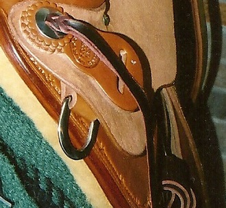

I also attached a picture of a tab on a leather concho. This is a saddle I did without strings so there is plenty of wood to screw into. I did a screw above and below the concho screw so they wouldn't be in a horizontal line and chance splitting the grain in the tree. I did more of these on cowboying saddles than arena saddles.
