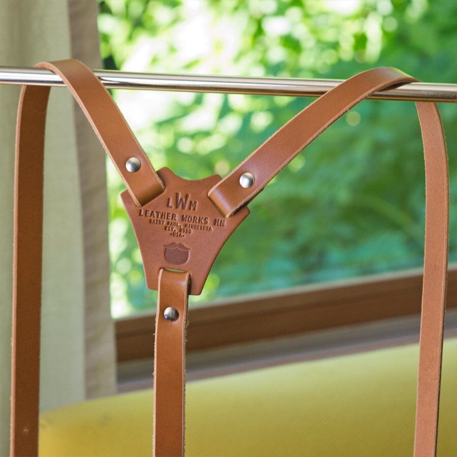

Members billybopp Posted August 21, 2014 Members Report Posted August 21, 2014 (edited) If you need an out of the ordinary color that is not available otherwise, then veg tan is your best bet. That said, there are a LOT of colors of leather available, and certainly all common ones in pre-dyed leather. 2/3 oz is about as thin as veg tan gets for purchase, but other types are are available a bit thinner. Many of them can be a bit stretchy, tho. A laser engraver could put your logo as well as cutting out the shape, but that's a pretty expensive option. If you end up using veg-tan, an arbor press and a stamp with your logo could work nicely. Otherwise, heat embossing is likely more cost effective, and can be done on many types of leather. Check here: http://lwleathers.com/products/leather-embossing A clicker press is more or less a big fancy squeezing machine to apply pressure over a large area. Assuming that your patch is pretty small, you need a little not-so-fancy squeezing machine to apply pressure over a not-so-large area. I can't say for sure, but an arbor press with a few modifications might do the job. Somebody that knows more about dies might be able to help with that. The above-mentioned LW leathers also make dies, so that might be a good starting point. Veg tan would need a finish, particularly if dyed. Garment leathers and some other types do not necessarily need any further finish (although some could benefit). Many vendors are wiling to provide for free or for a reasonable price, sample packs. Check some of the vendors' banner ads on this website. They are also a good resource to ask for info about any leather specifics. If you want bigger ( but not too big ) pieces of leather to experiment with, Springfield leather will sell many of their leather in small quantities. http://springfieldleather.com/ Another option that might be cost-effective for you is having the pieces made and ready to use. That would eliminate your capital and labor expenses for those parts. Springfield offers that sort of thing on a limited basis, so it could be worth asking! http://springfieldleather.com/9/Manufacturing-Shop/ Hope that helps Bill Edited August 21, 2014 by billybopp Quote

Members Cpack Posted August 21, 2014 Author Members Report Posted August 21, 2014 If you need an out of the ordinary color that is not available otherwise, then veg tan is your best bet. That said, there are a LOT of colors of leather available, and certainly all common ones in pre-dyed leather. 2/3 oz is about as thin as veg tan gets for purchase, but other types are are available a bit thinner. Many of them can be a bit stretchy, tho. A laser engraver could put your logo as well as cutting out the shape, but that's a pretty expensive option. If you end up using veg-tan, an arbor press and a stamp with your logo could work nicely. Otherwise, heat embossing is likely more cost effective, and can be done on many types of leather. Check here: http://lwleathers.com/products/leather-embossing A clicker press is more or less a big fancy squeezing machine to apply pressure over a large area. Assuming that your patch is pretty small, you need a little not-so-fancy squeezing machine to apply pressure over a not-so-large area. I can't say for sure, but an arbor press with a few modifications might do the job. Somebody that knows more about dies might be able to help with that. The above-mentioned LW leathers also make dies, so that might be a good starting point. Veg tan would need a finish, particularly if dyed. Garment leathers and some other types do not necessarily need any further finish (although some could benefit). Many vendors are wiling to provide for free or for a reasonable price, sample packs. Check some of the vendors' banner ads on this website. They are also a good resource to ask for info about any leather specifics. If you want bigger ( but not too big ) pieces of leather to experiment with, Springfield leather will sell many of their leather in small quantities. http://springfieldleather.com/ Another option that might be cost-effective for you is having the pieces made and ready to use. That would eliminate your capital and labor expenses for those parts. Springfield offers that sort of thing on a limited basis, so it could be worth asking! http://springfieldleather.com/9/Manufacturing-Shop/ Hope that helps Bill Thank you so much for the response!! I don't think the color is too out the ordinary. Here are some pics. I was thinking a tan to medium brown would work. These are pics I found off the internet. I've heard of people "rigging" an arbor press to do certain things. At the time I got my die and couldn't find anyone with a clicker press, I considered that but couldn't find anyone to help me rig it. As you can see from the brown suspenders above (those are mine) the back patch is really small. An arbor should work for both a stamp and the die. Any stamp companies you recommend? Question - after the piece is clicked out, will the edges have to be finished whether it's dyed or not? I keep envisioning somewhat frayed edges because the back of some leather is suede-like Springfield leather has been recommended to me three times now, and I did call but didn't get very far with help. I'm going to try them again. Thanks! CP P.S. Here are all my suspenders colors, which I didn't think it would be too terribly hard to find a color for. Quote
