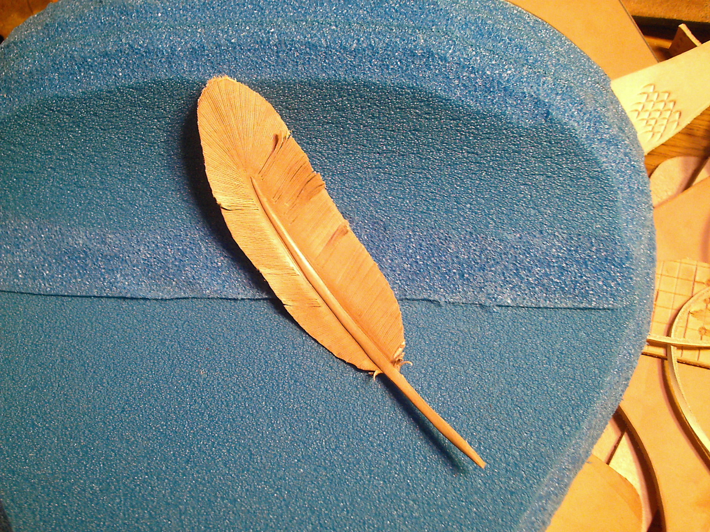

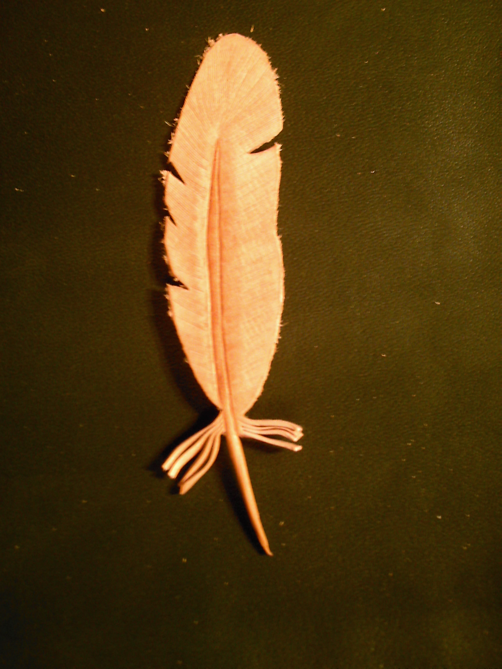

Not sure why, but I just wanted to try to make a realistic looking feather. I have seen others on here do it so I had to try. I started out with a heavy peice so I'd have the thickness for the center part. The quill I guess you call it. Then I just kept skiving it down on the edges till I got what I wanted. The one on the left is the front side. Still have some touchup to do. So, tell me what you think. I need the advice, good or bad.
Tom
Tom,
It looks pretty good. The thing that stands out the most to me is the "fluff" at the bottom of the feather. It's pretty thick. I'd try and make those a lot thinner if you can. If you skive that part of the leather down real thin, then make the individual cuts with a scalpel or x-acto knife, it might be easier. On the second picture (the horizontal one) the quill isn't real even at the bottom. The notches in the main part of the feather, looks like you cut out V's. I just make a slice along the veins, not cutting anything out. Not sure how you are going to finish this, but my next step is to put on an acrylic sealer and when that is still wet, you can twist and turn parts of the feather to shape it. I like mine to look pretty ragged, but that's just me.
Tom,
I did cut out vee's. Thanks. I plan to make a few more. I'll need to be more careful with my cuts on the quill part. I'm not really sure how to finnish it. I can see this shaping up to being something later on. Maybe part of a Dream Catcher or something. Thanks again for the imput.

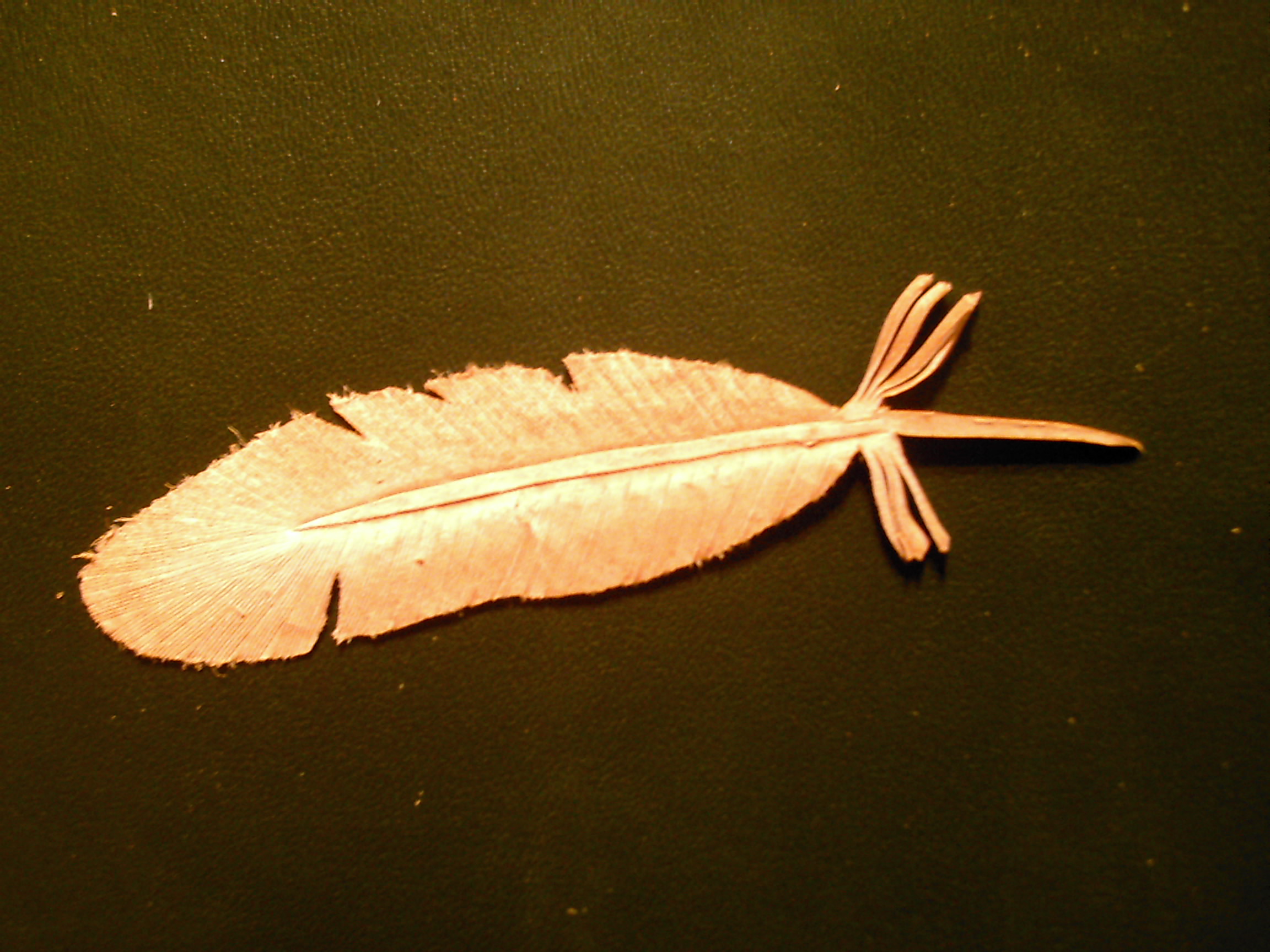

OK, here's another try at it. I need to clean it up some and maybe cut a few more loose feather parts in it but I think it's alittle better than the first one. Comments please.
Tom

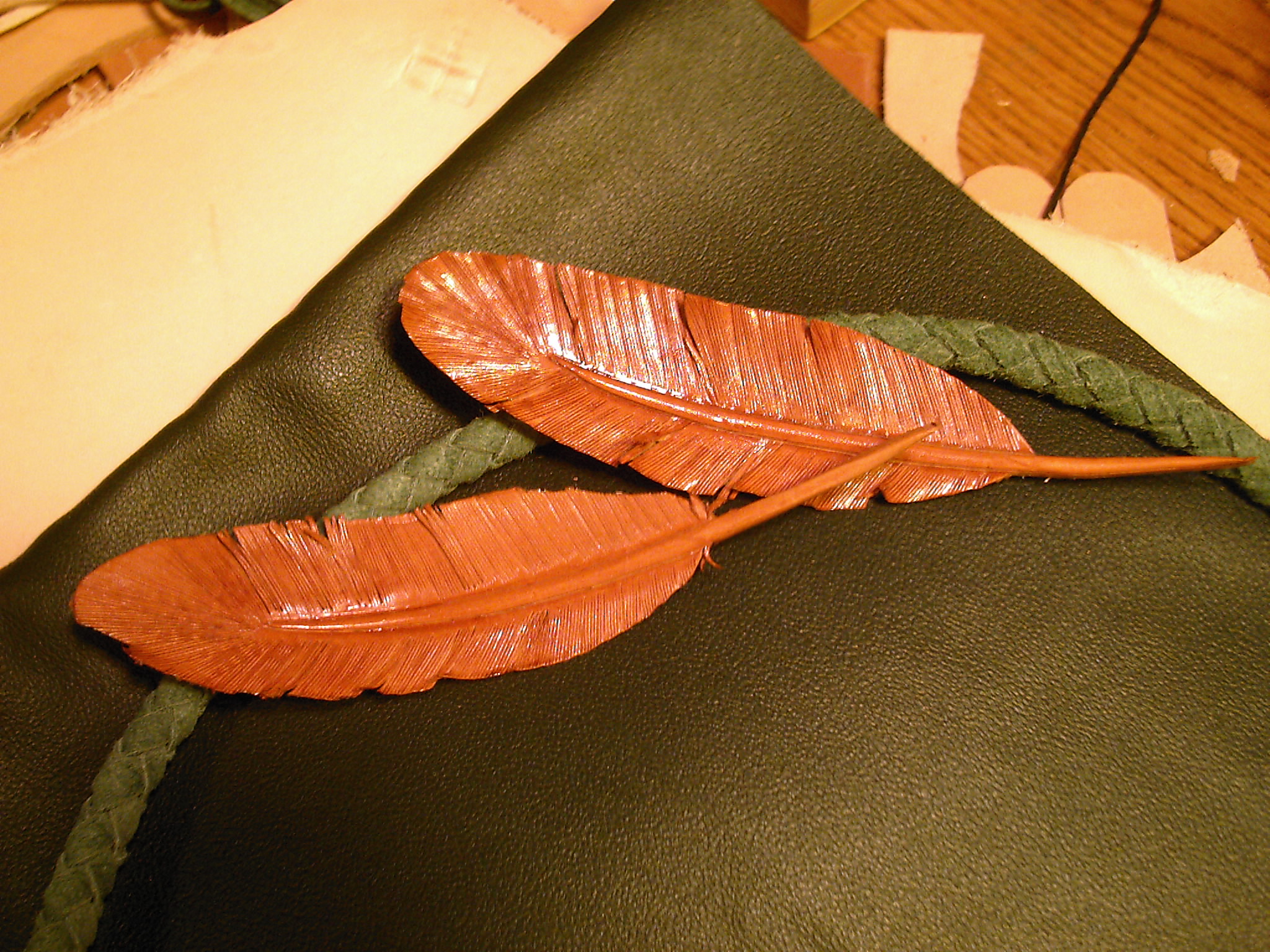

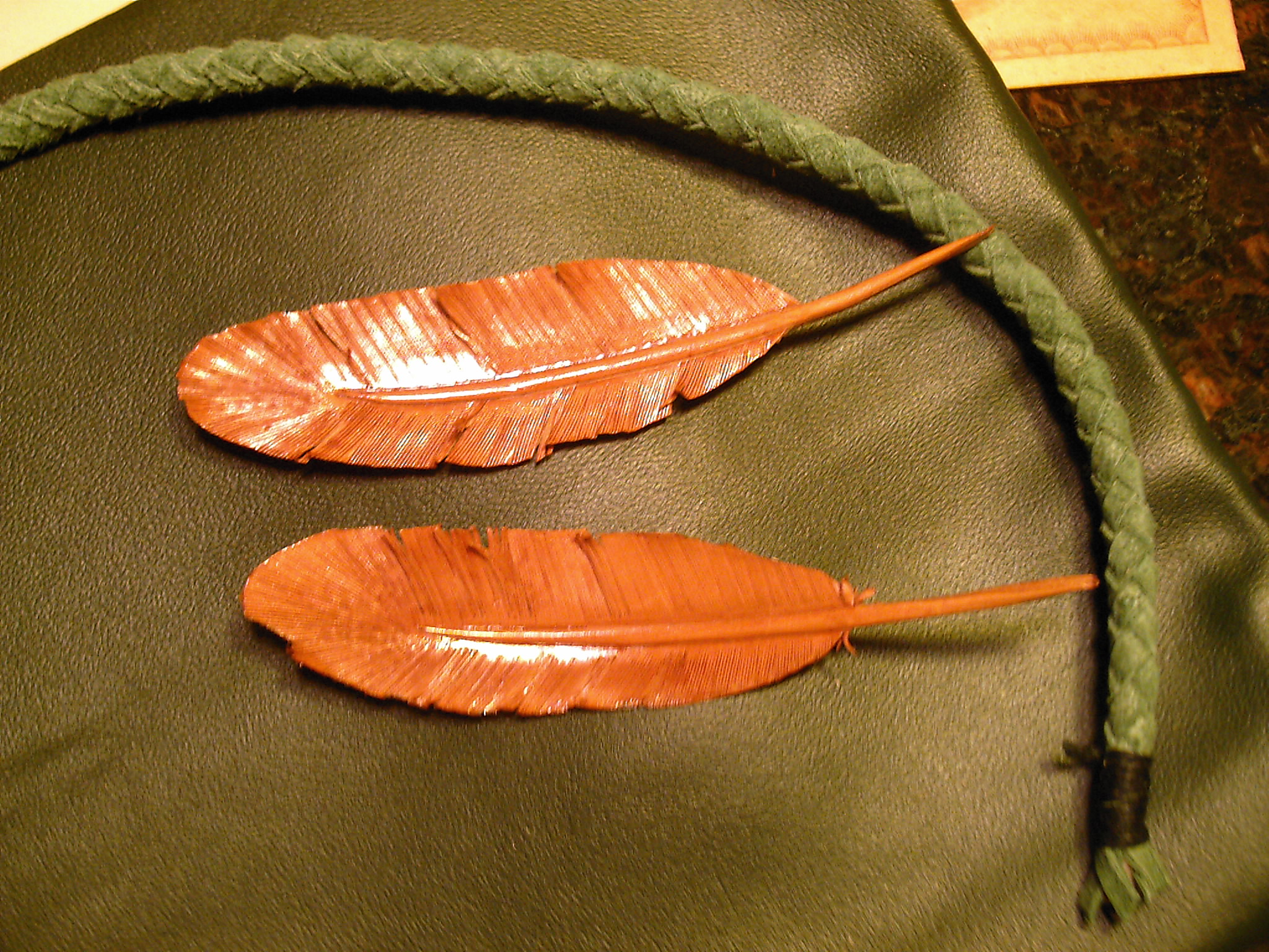

Two new ones with a coat of clear laquer on them to strenghten them. Now I'll airbrush the color on. Not sure what color. Anyone have suggestions? I was just going to look online at feathers.
Tom
Check out the gift shop on Paul Burnett's website. It should give you all kinds of ideas.
All I can say is WOW!! Love the red ones on page 6 and the turkey tail feathers. Thanks for the link.
Tom
