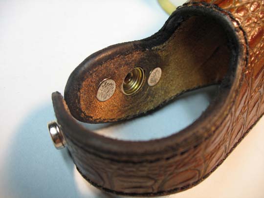

What I'm trying to describe (and not very well - I wish I could draw the explanation) is called a "thumb break." As it shows in your photo, the strap from the back goes over the tip of the hammer with the snap pointing up. The strap from the front of the holster has the other half of the snap facing down, and it snaps on top of the hammer. The user must find his shooting grip, and then bring his thumb back up and brush the flap of the front strap up and out, to unsnap the strap. He must then, as he draws the weapon, move his thumb back down the left side of the frame to his shooting grip position.
With a thumb-break, the snaps are in the opposite relative position (as though the back strap was on top in the arrangement you have now) only the rear strap is shorter and the front longer. This moves the secured strap around the left side of the hammer, between the hammer and the wearer's body. I usually double the leather on the rear strap to stiffen it.
When the officer draws the weapon, as his hand moves to his shooting grip, his thumb goes between the two straps as it starts down the left side of the frame and unsnaps the straps. As his four fingers tighten around the grip and pull the weapon up out of the holster, his thumb is on the left side of the frame, where it should be.
I hope this helps.
Mike
Tim, if you search in this thread for a post "New Holster for my Makarov" by ArtS, he has some great close-up shots of a thumb-break. Thanks Art!!!

I was looking at the same thing Mike. Other than that it looks great.
Here are some pictures of what Mike is talking about.
Art
