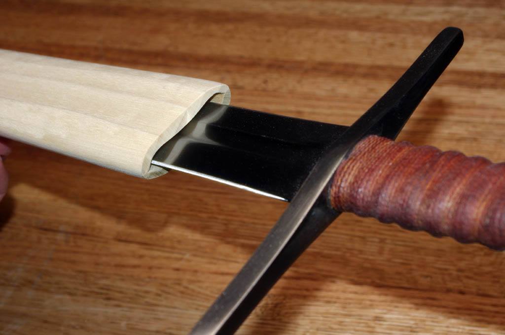

Members snoopers Posted October 5, 2014 Author Members Report Posted October 5, 2014 would I follow the same process to make a sword scabbard ????? Quote
Members Harry Marinakis Posted October 5, 2014 Members Report Posted October 5, 2014 (edited) would I follow the same process to make a sword scabbard ????? No. Sword scabbards are not made with hardened leather. Sword scabbards are either metal or they are made with a wood core covered with 2-3 oz. leather. Here is an example of wood core that I made for a sword: And here is a scabbard-making tutorial: http://www.yeoldegaffers.com/project_scabbard.asp Edited October 5, 2014 by Harry Marinakis Quote
