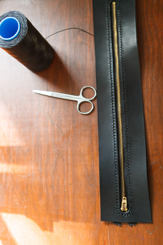

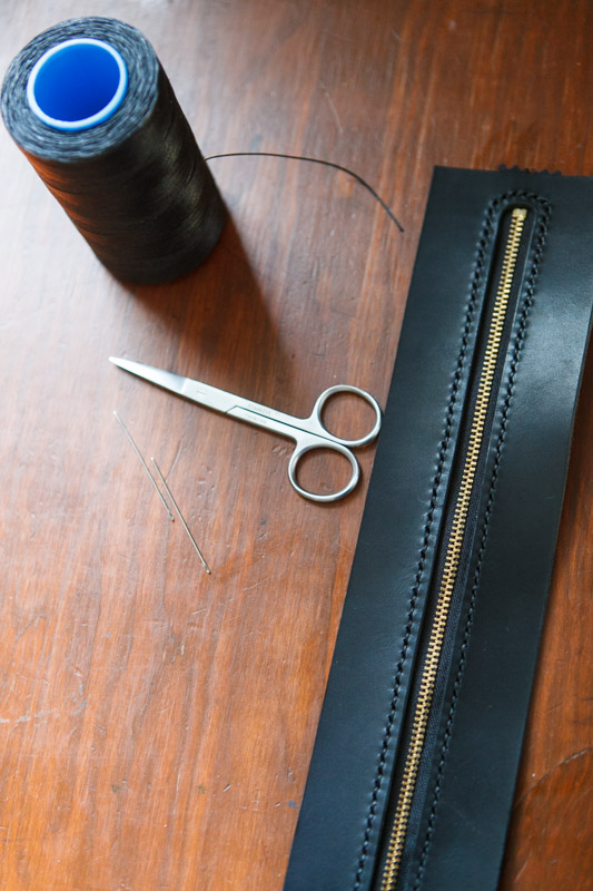

Members MonicaJacobson Posted October 20, 2014 Members Report Posted October 20, 2014 So... is this a legitimate way to put in a zipper? I'm doing a two piece gusset - bottom and sides are one piece, and the top, containing the zipper, is the last piece. Quote
Members Dwight Posted October 20, 2014 Members Report Posted October 20, 2014 If I understand you correctly, . . . looks good to me. The stitching around the back of the zipper end is for me one of the most important parts, . . . as an unbroken line of stitches will keep it all together and from shifting around. Show us the finished project when you get it done. May God bless, Dwight Quote
Members MonicaJacobson Posted October 20, 2014 Members Report Posted October 20, 2014 Okay, yes, the back is the same as the front - I just cut out a place for it, like installing a pocket zipper. It seemed the cleanest way of doing it to me, though it might not open as wide as other ways of installing it. I'll be interested to see how it turns out, too. I've never done a zipper bag before, or a gusset of this kind. Quote
