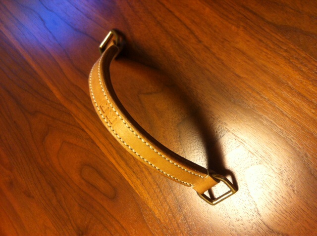

Basically Bob Report post Posted October 14, 2014 This was a quick project I put together for a lady who wanted a leather handle for a wooden case she uses to keep craft supplies in. Hand stitched at 7 spi. 5/18 barbour linen thread. Quote Share this post Link to post Share on other sites
MonicaJacobson Report post Posted October 14, 2014 It looks nice! Is the inside a welt, or is it all one piece? Quote Share this post Link to post Share on other sites
9tpi Report post Posted October 14, 2014 Nice stuff! What oz is they handle made of? Quote Share this post Link to post Share on other sites
Basically Bob Report post Posted October 14, 2014 Thanks, It looks nice! Is the inside a welt, or is it all one piece? Thanks Monica, I used one, 3/4 strip, 16 - 17" long, skived about 1" of each end to a feather edge. I folded the strip so that the ends were overlapping, created three layers in the middle. ("The Leatherworking Handbook" by Valerie Michael) 9tpi, it was 6/7 oz. I chose to leave the leather natural but conditioned it with Montana Pitch Blend leather dressing. Quote Share this post Link to post Share on other sites
MonicaJacobson Report post Posted October 14, 2014 Thanks for the info, Bob! Quote Share this post Link to post Share on other sites
25b Report post Posted October 14, 2014 Do you have a pic of the underside of the handle? Quote Share this post Link to post Share on other sites
Dan28 Report post Posted October 14, 2014 Nice handle. Just a few weeks ago, I was looking all over for pics of various handles trying to get an idea for how I wanted to do one. Only after I ended up making the one I used, did I come across the single piece of leather design for them. I think I probably would have used that design. Quote Share this post Link to post Share on other sites
Basically Bob Report post Posted October 15, 2014 25b, sorry I don't have a pic of the underside. The customer has picked it up. What I will tell you is that the stitching on the back is not as nice as the front, LOL. One thing that I forgot to mention is that I glued it up on the round. Used a roll of masking tape as my form Quote Share this post Link to post Share on other sites
