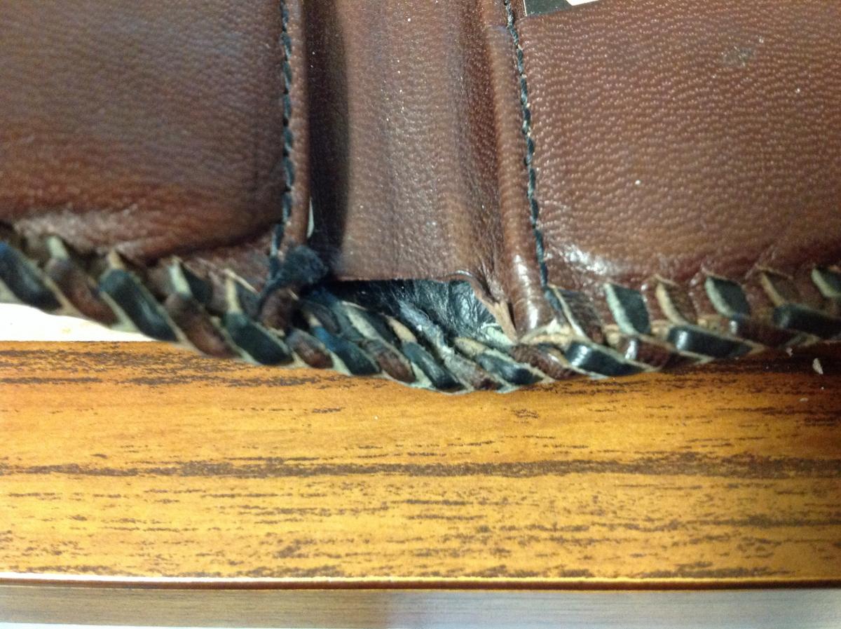

I have a question along this same line. When the back of the wallet is larger than the interior how do you space the holes for lacing and have the same amount of holes in the inside as well as the outside? Or do you somehow go through some holes twice on the outside and once on the inside?
Rohn
(John 8:32) And ye shall know the truth, and the truth shall make you free. (KJV)
You leave a section of the liner notched out and unlaced. The pic is old and worn, but you can get the idea from it.
post-2349-0-79136100-1414006186_thumb.jp
Thank you so much. That answers my question.
