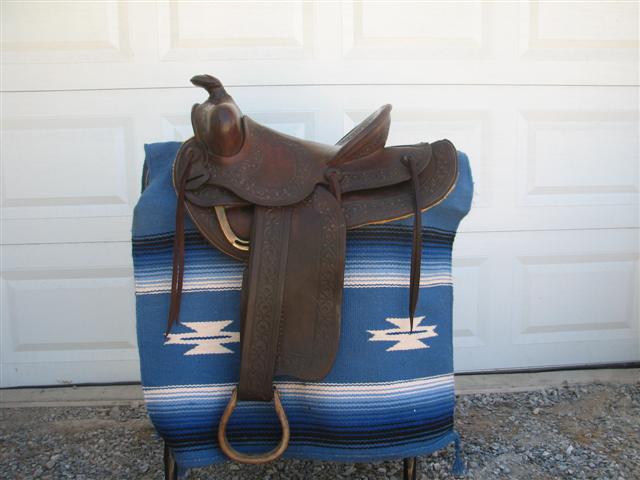

Pella,
Here is the northern cousin to your Texas saddle. This one came on a saddled horse in a trainload of cattle my great grandfather bought from Miles City in the 30s. Johanna probably didn't believe me at first, but it sits in my living room. Actually I have two oldies in here.

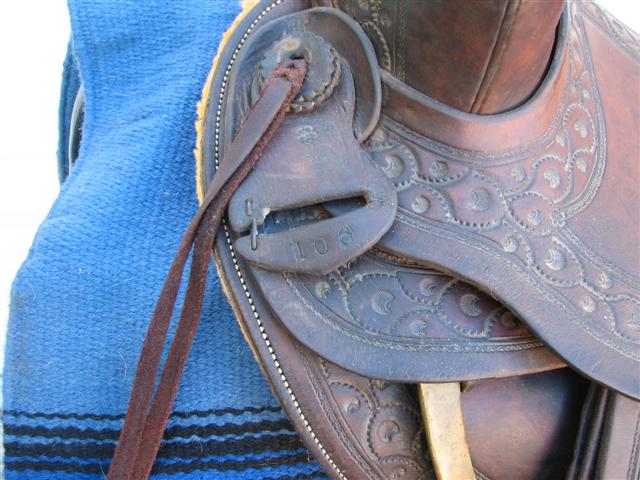

That was a pretty common way to cover horns back in the day. I have seen some with a small brass nail and others with a slotted head wood screw securing the tab. The saddle came from Duhamels on Rapid City, South Dakota. The latigo carrier for this particular maker was stamped with the model of the saddle - #106 was the Ellensburg tree from Newton Bros, I was told. I have always heard this pattern referred to a a shell pattern also. One guy who has a Duhamel catalog told me they called this pattern the "acorn". I would dearly like to get my hands on a Duhamel catalog. The only one I have ever seen was under glass and they couldn't open the case. I heard from a collector that one of the Mile City catalogs called it an acorn pattern too, and another Miles City shop called theirs a shell.

The saddle i have here is stamped "471" on the front jockey. Thanks for the details, very interresting and i can see i was on the good way about no metal concho and age of the saddle. Did you change the rigging dee?

I post more picture of the "acorn" or "shell" motif for comparasion and reference. Also a picture of the front fork.

I'll attach a couple of pics that show the fenders.
Pella,
I didn't change the rings. These are probably the original EZ dees. I think the EZ dees came out about 1915 or so. Interesting note - these dees are curved to follow the contour of the horse. I had thought for years that it was from use. After reading a discussion among some other makers, I am sure someone formed them. Several guys will form the larger rings to have that slight arch before they hang them on the saddle.
The horse was saddled for the train trip. My great grandfather used to feed a lot of cattle. He asked for them to send along a ranch horse on a load. He came down the ramp packing this saddle. He must have been pretty broncy. Apparently he rode the horse to my grandpa's. He could tell he was having some trouble with him and offered to drive him home and they'd lead the horse out the window. Great-grandpa figured he got him there, he could get him home. My dad isn't sure, but seems to remember he sold the horse to a local guy who put on Sunday afternoon catch-all bronc ridings.
