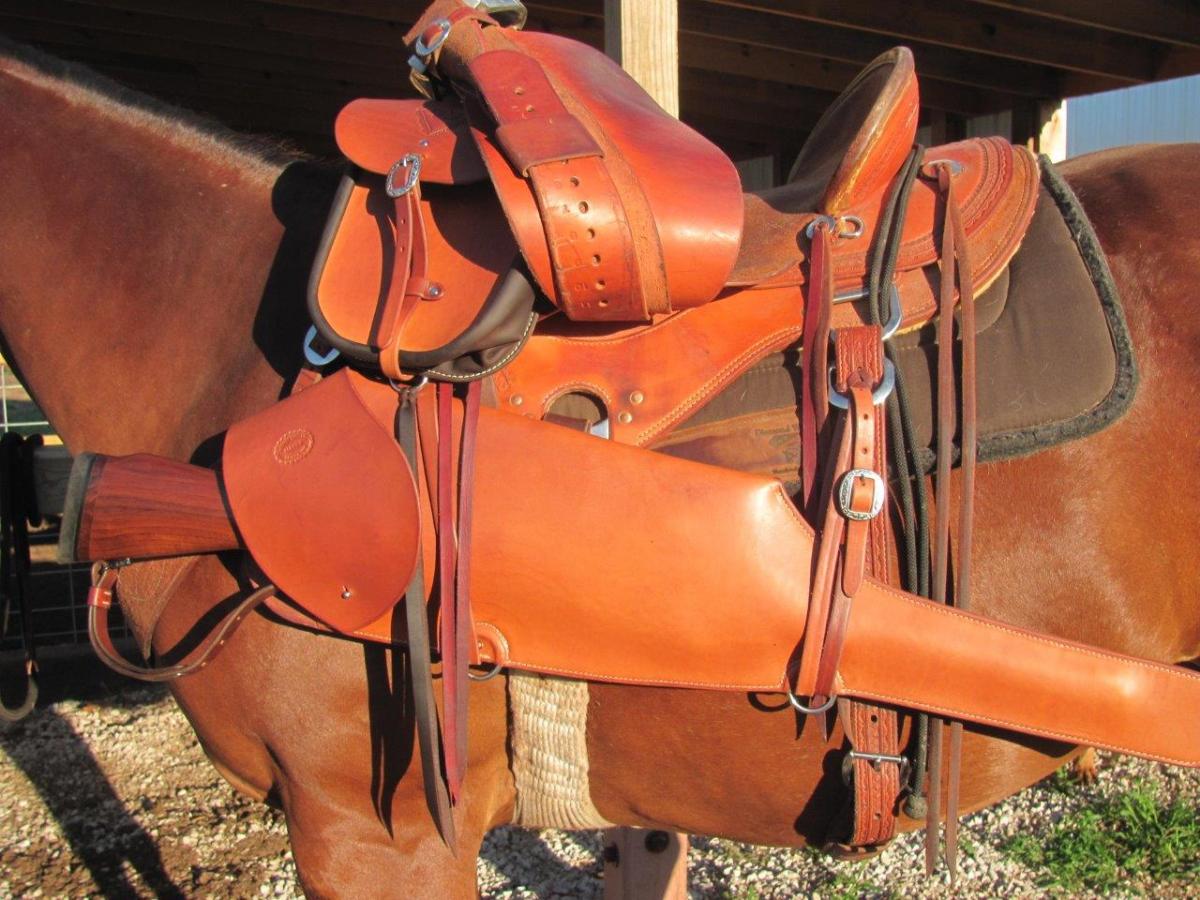

Depends on the look you're going for. If you want a "period" or "authentic" look go with the two coats of NF then rub in a healthy amount of Aussie Wax or Sno Seal and set it in the sun for a few hours on each side. It'll make a durable rugged look that gets better over time. The scabbard, bags and saddle pictured below were finished this way. Keep in mind, the more sun they get, the darker they get.
Good luck, Josh
