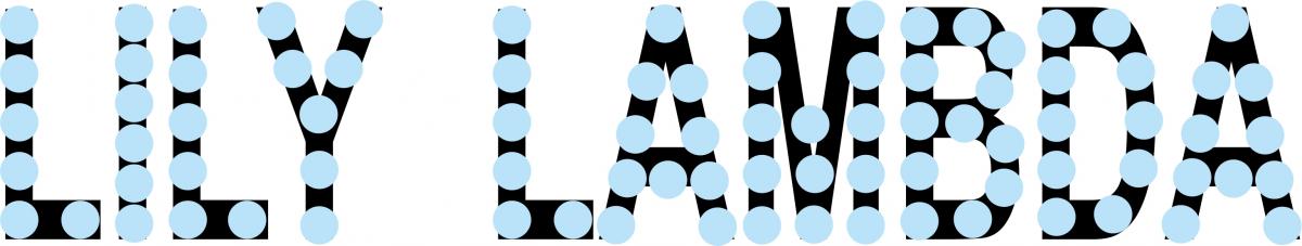

Well, I ran it through my programs and the issue is the rivet size.
Figuring a 1" tall x 7" long name, using the Tandy Small rivets, they just don't fit. The heads are a tad over 7mm. Most rhinestones are in the 2-3mm range.
Here's what it comes up with. Even moving and adding rivets, you still have spots that they just don't fit.
Now, you could use the small crystal rivets, or even heat press stones and manually place the stones on the adhesive transfer paper. I have done that before and it's OK for 1 or 2 items of small to moderate size.
post-14889-0-08671100-1414711235_thumb.j

Here are a few other samples. I stretched it out to about 10" long and 1-3/4" tall. Using the Small rivets (7.3mm) for the first one. Still looks bad, especially when I remove the black lettering. That's the second photo. The M is the main problem
I set it for a standard rhinestone pattern using SS6 (2.3mm) stones and center line.. Same problem but not as bad.. Still not usable..
The last one, is SS6 stones using outline. Looks nice.
But unless you can find some extra small rivets, you may just have to use the graph paper idea that Billy suggested once you see the actual rivet size.
