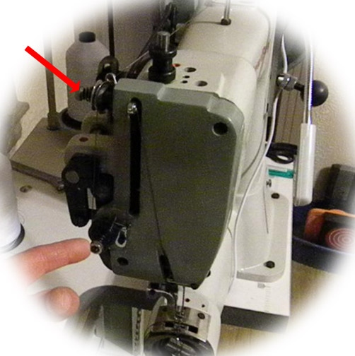

Members cleanview Posted November 16, 2014 Author Members Report Posted November 16, 2014 They are not believers in instructions thats for sure. To be clear......this is my tension setting for the top thread And the bobbin is where the bottom tension is set? Quote Amarillo Texas bambamholsters.com

Contributing Member JLSleather Posted November 16, 2014 Contributing Member Report Posted November 16, 2014 (edited) I got no instructions for that machine, but isn't the top tension set up above? And I agree.. for a couple THOUSAND dollars, you'd think there would be a current manual. Ten $$ hand tools from Tandy come with instructions, or at least a picture... Edited November 16, 2014 by JLSleather Quote "Observation is 9/10 of the law." IF what you do is something that ANYBODY can do, then don't be surprised when ANYBODY does.

Members cleanview Posted November 16, 2014 Author Members Report Posted November 16, 2014 JLS -- guess I tightened the wrong thing. What did I tighten? At the same time that I tightened the wrong adjustment I switched from 207 to 277 so I guess that could have tightened it up or it was just my imagination. Red ---- that bit about shortening for the curve is priceless, I guess after a time or two I could know just how far to turn, I dont think i would be comfortable just hand bumping the lever though I guess that could be done as well I sat and watched the movement of the bobbin and think I have it understood now, AM I CORRECT that once the hook picks up the thread and start moving it is then the opportune time to left the lever and make a sharp turn?? And I am unclear as to how the locking the stitched in works. I am supposing that it is the reverse action that going over backwards locks them into place (still unclear in my mind). If that is the case then would just completing the circle and passing over the first 3-5 stitches "lock" them?? Again appreciate the time and patience to help me. Quote Amarillo Texas bambamholsters.com
Contributing Member JLSleather Posted November 16, 2014 Contributing Member Report Posted November 16, 2014 (edited) It would be difficult - to say the least - to keep a good eye on the bobbin and the corner at the same time. Simply put, the needle needs to go all the way down AND START BACK UP before making the turn. As for tensions, basically you're running bigger thread through the same hole, which would logically be tighter. So, IN THEORY if you switched the bobbin AND the top thread size together, the tension shouldn't require much adjustment, if any. Think of a scale, and then add 10 lbs to each side. Still balanced, yes? Other hand, for example... if you left the 207 in the bobbin, and changed the top to 277, then you might find it a bit tighter in the top (which "should" result in a bottom thread pulled up a bit too far). In this case, a guy might turn that top tension BACK (likely counterclockwise on yours). Turn it like 1/8 to 1/4 turn, then test it. It don't take that much, with a new spring in there (which yours would be). By way of a low-rent TIP: Some folks might put a dab of color on the thumbscrew so you know how much it turned. Personally, I generally remember, but a feller COULD ask the wife for a drop of nail polish. Actually, that's probably not politically correct any more --- some 'fellas" got nail polish too Edited November 16, 2014 by JLSleather Quote "Observation is 9/10 of the law." IF what you do is something that ANYBODY can do, then don't be surprised when ANYBODY does.
