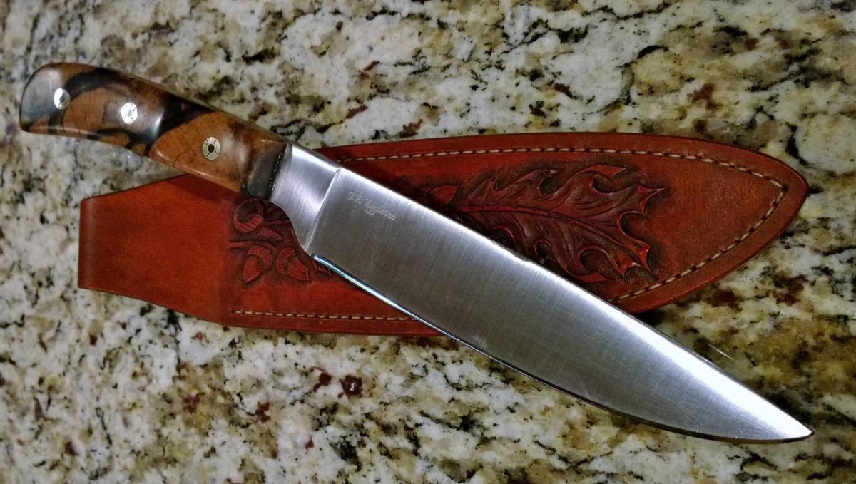

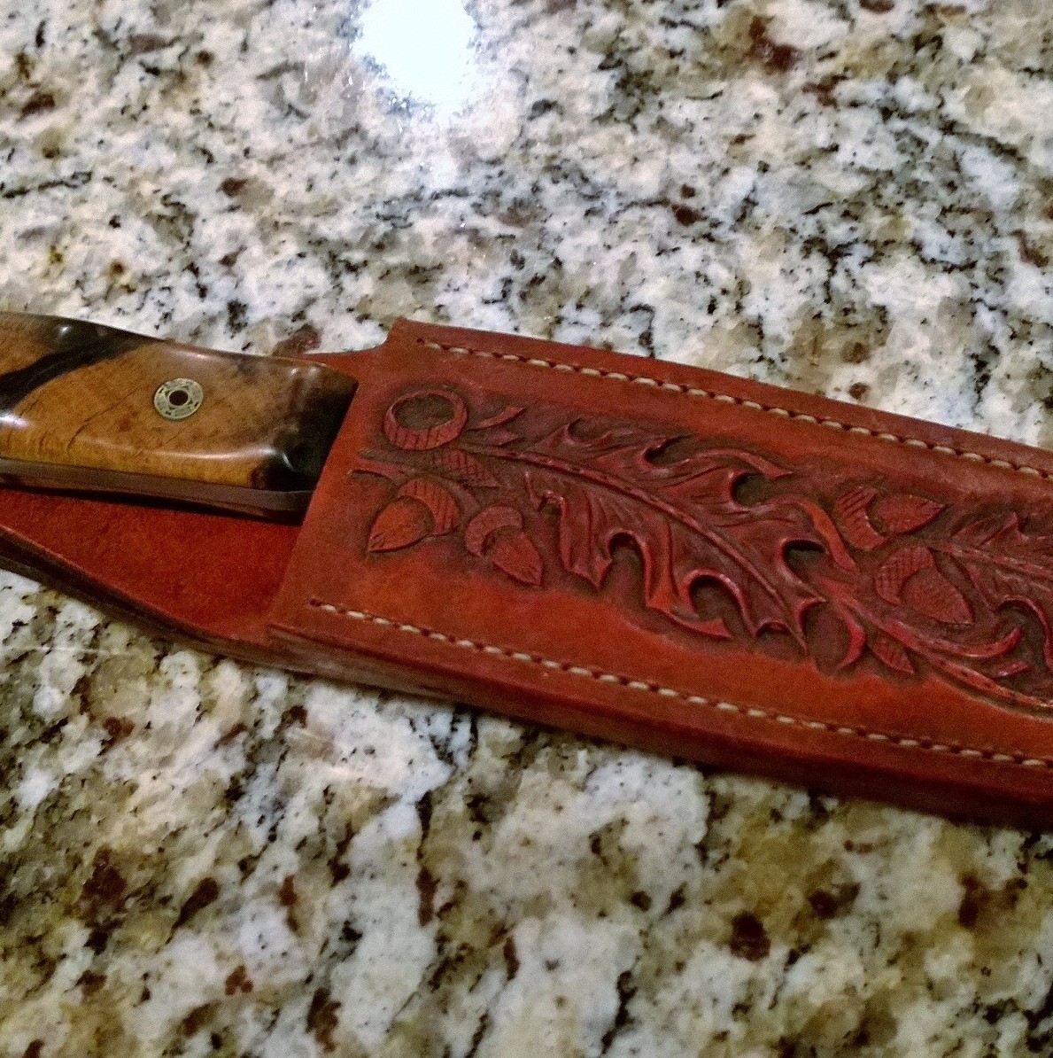

Members snubbyfan Posted December 4, 2014 Members Report Posted December 4, 2014 As Peter pointed out you can stamp and carve anywhere you feel like. Just make sure both sides and equally pretty. I personally don't stamp the backside but that's my personal choice. Leatherwork lends itself well to personal expression. I agree with cgleathercraft, flip that belt loop over and finish the flesh side. I'd extend it further down the back of the sheath. Just make sure to recess the stitches so the knife doesn't snag and possible cuts them. That's how I've done these holsters and knife sheath. Front side. Or as camano ridge said, flip it forward and skive it in. Having a woodworking background, I have a drill press in which I've chucked a large sanding drum. That enables me to use both hands and guide the piece. As I've done with these sheaths made for a Cherokee friend. Many of my sheaths are made for people who have a nice knife and they want a nice sheath to go with it. This one's a user for a left handed individual. The stud for the hold down strap's closer to the hilt to make it easier to use with one hand. Quote
