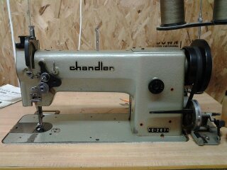

Members novaroper Posted December 3, 2014 Members Report Posted December 3, 2014 well I just got a chandler c267 and sews great and has same size bobbins as my juki563 what is the big diferance besides how the bobbin loads not sure which one to keep Quote
Members shoepatcher Posted December 3, 2014 Members Report Posted December 3, 2014 I would keep the LU563 Juki. Vey good machine, parts readily available, reverse and nice big bobbin. Plus Juki is a major name in sewing and the machine is proven. Is the Chandler and Adler 267 with the chandler name on it? glenn Please send us pics of each machine. glenn Quote
Members novaroper Posted December 3, 2014 Author Members Report Posted December 3, 2014 the chandler has same size bobbin and reverse and I thought chandler was made by adler and adlers were made in germany but it says made in japan on the back so kind of cunfused about that Quote
Cobra Steve Posted December 4, 2014 Report Posted December 4, 2014 Adler used to distribute machines with the Chandler name on them back in the late 60's and 70's just like shoepatcher implied. They are no longer in business, but Juki is. I would stick with the Juki. Steve Quote Thank You Steve Tayrien Leather Machine Co., Inc. 2141 E. Philadelphia St. Unit "U" Ontario, California 91761 1-866-962-9880 http://www.leathermachineco.com cobra@leathermachineco.com
CowboyBob Posted December 4, 2014 Report Posted December 4, 2014 They both are correct,keep the Juki feet & other accessories are a lot easier & lower priced for it because it is a very common machine. Quote Bob Kovar Toledo Industrial Sewing Machine Sales Ltd. 3631 Marine Rd Toledo,Ohio 43609 1-866-362-7397
Members novaroper Posted December 5, 2014 Author Members Report Posted December 5, 2014 I got 3 or 4 different types of feet with this chandler they look like they will fit my juki will they? Quote

Members Gregg From Keystone Sewing Posted November 30, 2015 Members Report Posted November 30, 2015 (edited) I was reading this and working off of memory (a bad thing for me to do, but it worked here) and I recalled an issue that came up years ago, and did some reading from my deleted emails. Hope this helps. The machine being refereed to here is a Nakajima, made in Japan, their model was 280L. This machine then became the Juki DNU-241(HS), and is now superseded by Juki's new and current model DNU-1541(S). Chandler, and independent dealer, would remove tags and brand this machine as "Chandler brand, model C-267". Not to be confused with an Adler 267. See attached image and owners manual to reconfirm this. Parts and accessories are readily available for this machine. Hope this helps, you have two really good Juki type machines there, both are from about the same vintage. I was reading this and working off of memory (a bad thing for me to do, but it worked here) and I recalled an issue that came up years ago, and did some reading from my deleted emails. Again, Hope this helps. JUKI DNU-241HS Parts List.pdf Edited November 30, 2015 by Gregg From Keystone Sewing Quote Industrial sewing and cutting, parts sales and service, family owned since 1977, Philadelphia, Pennsylvania USA, 215/922.6900 info@keysew.com www.keysew.com

Members Constabulary Posted November 30, 2015 Members Report Posted November 30, 2015 Oh - holly crap - I did not know. I only knew Chandler sold the Adler 67 as Chandler 67 so I assumed the C-267 would be the Adler 267. I always learn something new every day! Thanks for the info Gregg! Quote ~ Keep "OLD CAST IRON" alive - it´s worth it ~ Machines in use: - Singer 111G156 - Singer 307G2 - Singer 29K71 - Singer 212G141 - Singer 45D91 - Singer 132K6 - Singer 108W20 - Singer 51WSV2 - Singer 143W2
