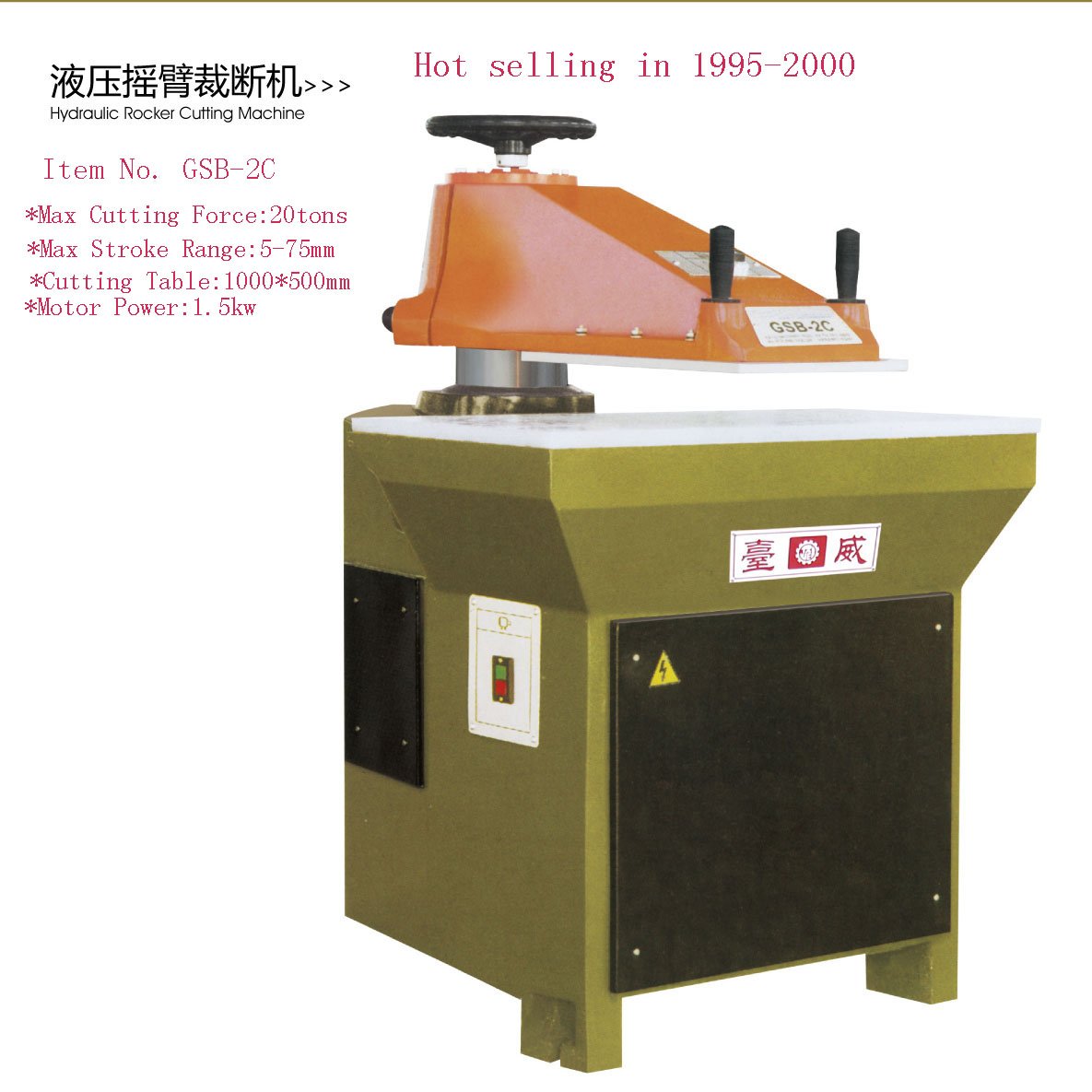

Members Handstitched Posted January 7, 2015 Members Report Posted January 7, 2015 G'day, I have an early USM GSB-2 20T cutting press just sitting in my workshop. Quite an old machine, but fully operational, but I haven't used it...yet. Its only been sitting there for about 5 years . Like the one in the pic, but nowhere near as nice looking. The original price was $7,250 aud. I bought it for $800 aud from a former leatherworker. And only $30 bucks to transport it. I also paid around $1000aud for a stack of assorted cutters of different shapes etc. Quite a bargain. BUT, It needs 3 phase power, and where live in the central wheatbelt of Western Australia ( the bush) theres no 3 ph. power or infrastructure, so I would need to get a hefty 9-11KVA 3ph generator to start it, due to the size/weight of the flywheel & oil pump attached to the motor.Once started, it would only need half that. Depending on what sort you buy, this particular machine would need 55ltrs of oil ( about 12 gal. in your measurement) for an oil change. When I bought it, the seller advised me to keep it serviced regularly ( depending on use). He also suggested that each and everytime I turn it on "put a few dollars into a tin" to go towards servicing ( or repairs) . Mine is an older machine, but a newer machine may not need as much attention. (?) Just do some number crunching, work out the economics, and benefits etc. before purchasing. HS Quote ' I have a very gweat friend in Wome called Biggus Dickus, He has a wife you know, do you know whats she's called? Incontinentia.......Incontinentia Buttocks '
