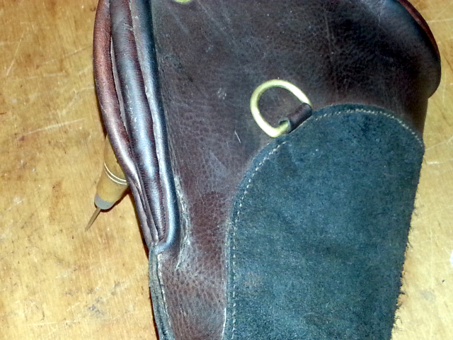

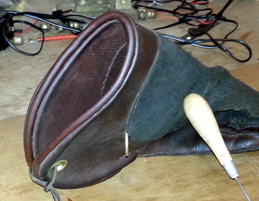

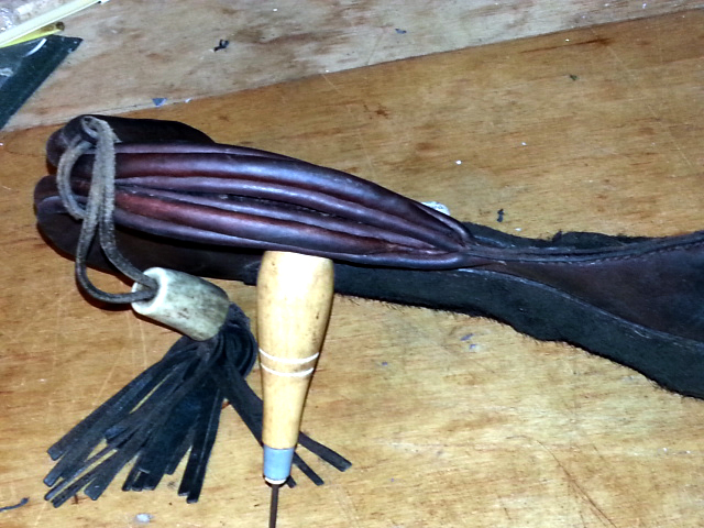

Members Birdman Posted January 10, 2015 Members Report Posted January 10, 2015 They are made inside out and then turned the right way. Dampen leather where it will be turned before turning. Use a rolling block to finish off. Attached pics are of the rolled edge on a falconry glove. Its been in use for 3 seasons, so apologies for not showing something pristine---but it shoes the work lasts! The pics also show how to finish the ends. Hope this helps. Quote Age and treachery will always overcome youth and vigour.
Members Harry Marinakis Posted January 10, 2015 Author Members Report Posted January 10, 2015 They are made inside out and then turned the right way. Dampen leather where it will be turned before turning. Use a rolling block to finish off. Attached pics are of the rolled edge on a falconry glove. Its been in use for 3 seasons, so apologies for not showing something pristine---but it shoes the work lasts! The pics also show how to finish the ends. Hope this helps. Sorry, I don't get it. Can you please elaborate? Quote
Members Birdman Posted January 10, 2015 Members Report Posted January 10, 2015 Here we go... OK. Look at the pictures above. You will see that the rolled edge is actually made up of 3 pieces of leather. The middle bit is the bit that rolls. It needs to be thinner than the other two pieces. Its width is determined by the size of the filler that is placed inside this middle piece that is rolled. In the pics, the middle piece is about 1". that has produced a roll of about 1/4" >3/8". A length of para cord was use as the filler in the illustrated example, but you could use thronging, strimmer line, leather strips, thread etc You stitch together the edges of the 3 pieces of leather taking care to join them in such a manner as you wish to see the finished item. ie if you want all surfaces showing to be grain, then you join the grain sides and stitch from the flesh sides. Next stage is to put the insert over the centre piece. A tad or two of contact adhesive will hold it in place. Then dampen the grain side of the centre piece. Then you close the two stitched edges together and stitch. Use the existing stitch places, but, if say you stitched at 8/", do every 3rd mark---just enough to hold the edges closed but not so much as making a load of extra work. This will close the roll. Then re dampen the rolled centre piece AND the stitched seams and flip it so that the other two pieces meet and leave your rolled edge on the outside. Bingo! A rolling/rounding block can be used to further enhance the shape. This is a lump of hard wood that has had a series of half round grooves of varying widths routed into it. The wetted leather roll is laid into the appropriate groove (start with a larger groove) and tapped gently along the stitched edge with a tack hammer. Move leather to a narrower groove and repeat. And so on and so on....... This moulds the roll. Allow to dry. I hope this does not appear as clear as mud! Quote Age and treachery will always overcome youth and vigour.
Members Harry Marinakis Posted January 10, 2015 Author Members Report Posted January 10, 2015 Got it, thanks! Is this what you mean? Quote
Members Birdman Posted January 10, 2015 Members Report Posted January 10, 2015 Yes. Quote Age and treachery will always overcome youth and vigour.
