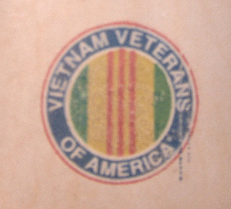

Members Dwight Posted February 4, 2015 Author Members Report Posted February 4, 2015 (edited) This is not a very good picture, . . . my apologies, . . . and it IS THE RAW piece of leather with the image on it. Notice down around 4 o'clock on it, . . . I smudged it slightly getting the thing laid down, . . . But the colors are 80% or so vivid, . . . I'm thinking a sealer of some kind will make this thing a keeper. Anyway, . . . take a whack at it, . . . see what you all come up with, . . . I'm kinda excited about it. (edited to say that the fuzziness is the picture's fault, . . . the actual image is in the 80 / 90 % crisp region, . . . very presentable in my estimation) May God bless, Dwight Edited February 4, 2015 by Dwight Quote If you can breathe, . . . thank God. If you can read, . . . thank a teacher. If you are reading this in English, . . . thank a veteran. www.dwightsgunleather.com
