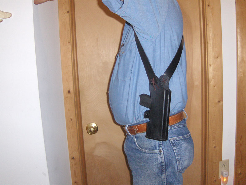

rbrooks, . . . I don't do a lot of shoulder holsters, . . . but mostly when I do, . . . they are "different".
This is an example, . . . if I remember correctly it is an M&P 9mm, . . . and it had a laser on it. Nice weapon, . . . pain in the watoosie to make a holster for it.
I refuse any and all horizontal shoulder holsters for striker fired weapons, . . . but I will make em muzzle down like this one.
Take a look at how I did it, . . . it uses a thumb break for retention. A double mag pouch on the off side makes it ride easier with less shifting.
Holler back if you have any questions, . . . more than happy to help.

post-6728-0-94818700-1423317623_thumb.jp
post-6728-0-90999500-1423317640_thumb.jp
post-6728-0-01287000-1423317655_thumb.jp
post-6728-0-73826400-1423317673_thumb.jp
post-6728-0-60431300-1423317687_thumb.jp
