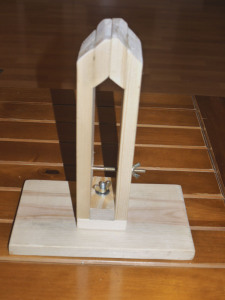

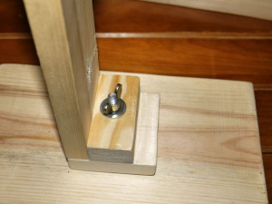

Mark Peters Posted March 30, 2015 Report Posted March 30, 2015 (edited) Built with poplar. Used a t-nut on the side opposite the start nut to hold the 1/4" screw in place. I think I'm going to replace the star nut with a larger version to get better leverage in tightening the clamp. Edited March 30, 2015 by Mark Peters Quote
Members Tugadude Posted March 30, 2015 Members Report Posted March 30, 2015 Very nice! Remember though, a bigger knob is just a greater chance of snagging your thread. So do it if you need for functionality, but not just 'cause. Love the long pieces at the top. My first pony (not the toy!) was hand built but I based it on the $80 one that Tandy sells. I found it too narrow at the top. My "fix" was to use a couple thin strips of wood or plastic to extend the length when working on a belt or whatever. The other thing that comes up is angle. Incorporating a way for the uprights to rotate is handy sometimes. Anyways, nice work! Quote
Members silverwingit Posted March 31, 2015 Members Report Posted March 31, 2015 (edited) Instead of a bigger knob you might consider a cam clamp like one from Rockwell. (Google "Rockwell cam clamp"). I won't go back to a knob again. This tightens the jaws tight with a flick of the lever and is far less likely to catch the thread, especially if you turn the lever facing up. They come 2 to a pack. Michelle Edited March 31, 2015 by silverwingit Quote

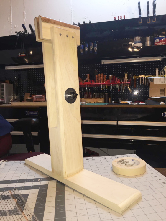

Members LoneWolf1973 Posted March 31, 2015 Members Report Posted March 31, 2015 (edited) On 3/30/2015 at 12:39 PM, Tugadude said: Very nice! Remember though, a bigger knob is just a greater chance of snagging your thread. So do it if you need for functionality, but not just 'cause. Love the long pieces at the top. My first pony (not the toy!) was hand built but I based it on the $80 one that Tandy sells. I found it too narrow at the top. My "fix" was to use a couple thin strips of wood or plastic to extend the length when working on a belt or whatever. The other thing that comes up is angle. Incorporating a way for the uprights to rotate is handy sometimes. Anyways, nice work! I have posted plans on this site to make one. As Tugadude said about the rotation, on those plans it showed at the base making the upright actually connected solid and taking a base below them with a bolt all the way thru so it can rotate. I will post those plans here and maybe you can use some of the ideas. I built me one and I love it. Leather Stitching pony english.rtfFetching info... Edited March 31, 2015 by LoneWolf1973 Quote https://www.facebook.com/lonewolfsleather/

Mark Peters Posted April 1, 2015 Author Report Posted April 1, 2015 The tilt/angle idea has me thinking of a slight redesign with a pivot point at the bottom of the clamp faces and a series of holes in an arc. Perhaps in 15 degree increments Quote
Members Tugadude Posted April 1, 2015 Members Report Posted April 1, 2015 On 4/1/2015 at 4:58 PM, Mark Peters said: The tilt/angle idea has me thinking of a slight redesign with a pivot point at the bottom of the clamp faces and a series of holes in an arc. Perhaps in 15 degree increments Sounds like a good idea! Quote
