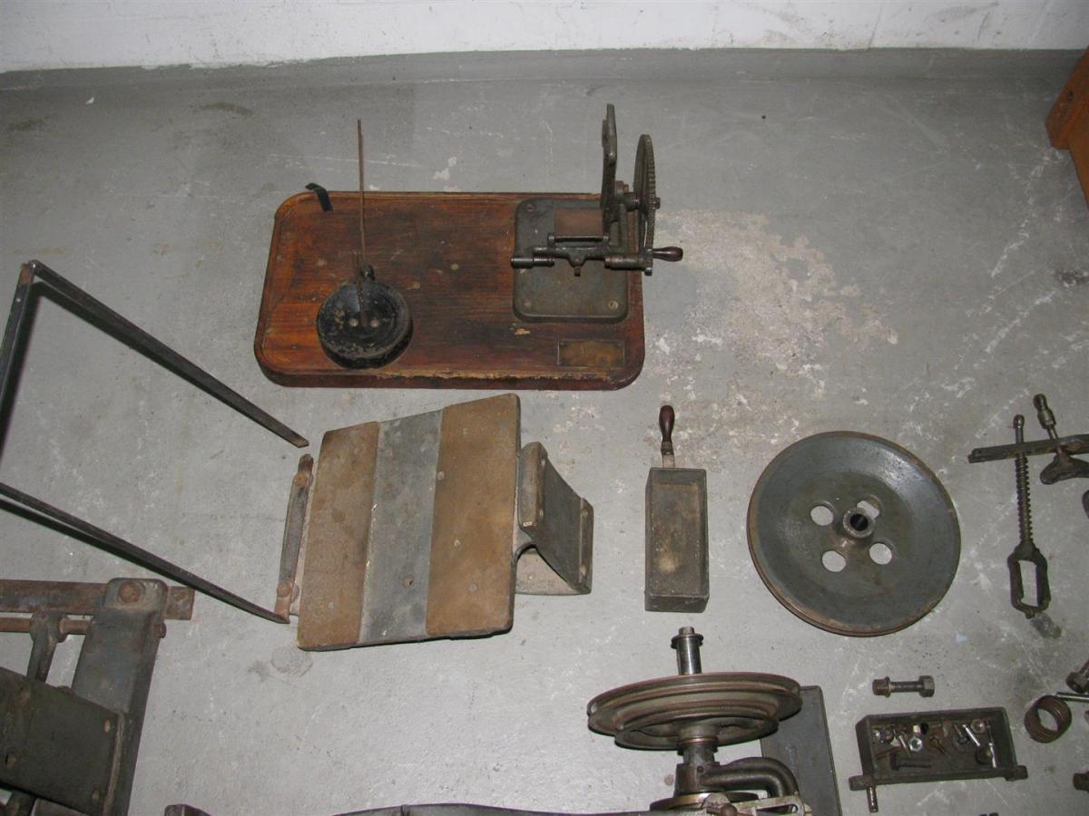

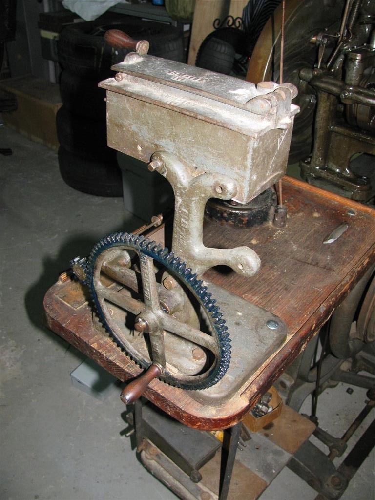

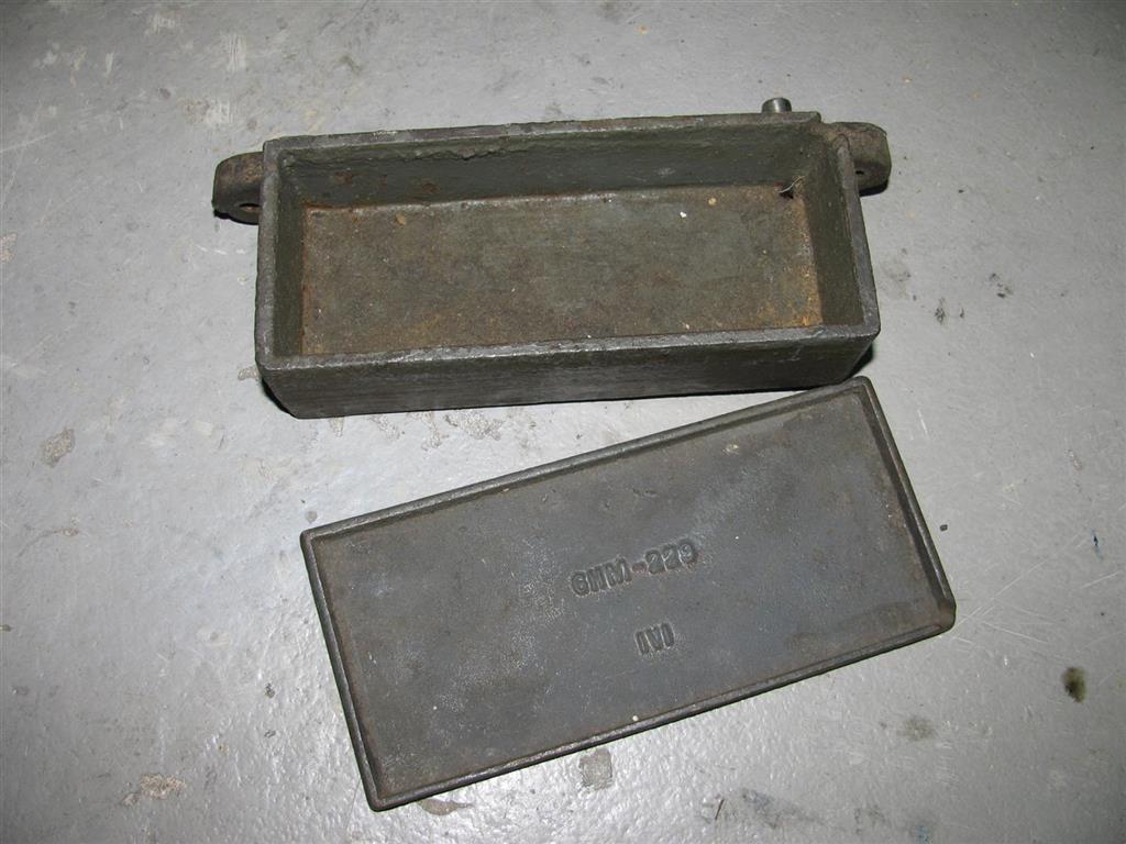

I have to do some repairs on my and a friends army tent but these canvas monsters are heavy and I don´t want to rip apart my Singer 133K carry it downstairs reassemble everything just to find out that the machine can´t do the job. So in the recent days I was hunting for a proper "tent repair machine"...
I´m sure flat bed machines are better for the job but I stumbled over this one by accident and by the Lord I could not resist buying it and so picked it up today. :)
So from what I can tell it is a BUSM / Pearson #6 but (maybe) made in Germany or "relabeled" BUSM for a German distributor. I will do some research to find out more...
Anyway - here are some pictures for the cast iron lovers out there:

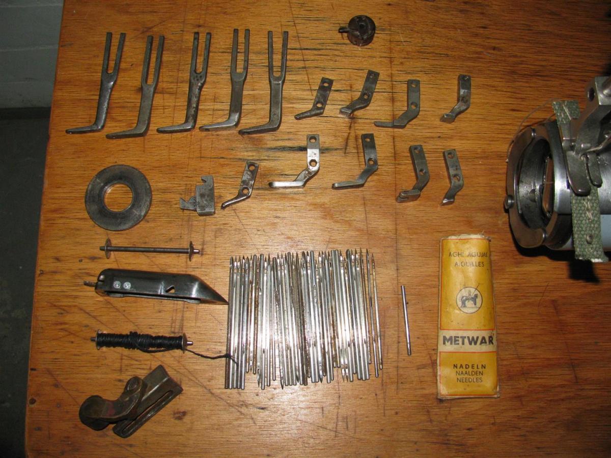

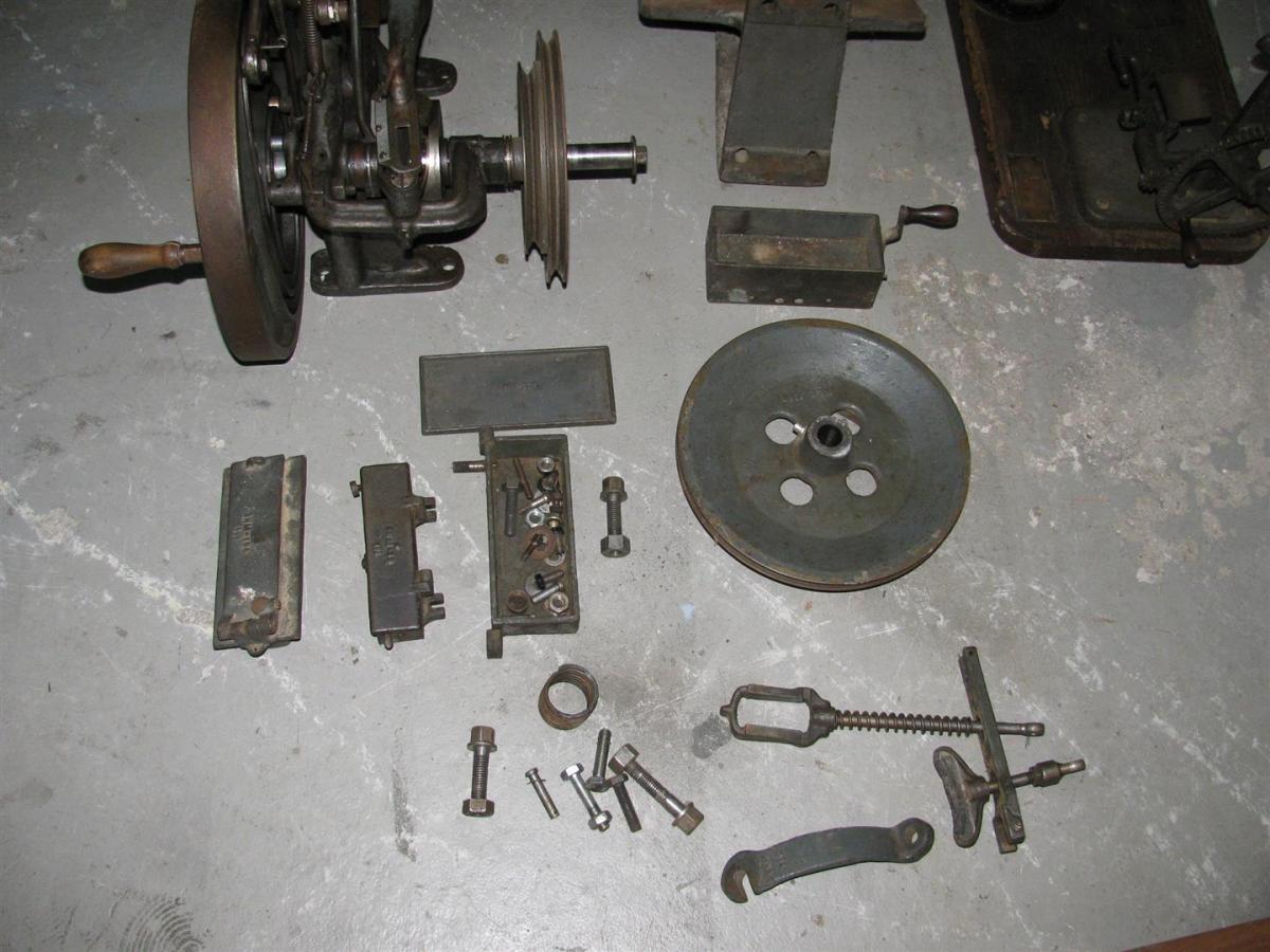

Due to the gray paint job (German field gray?) I would guess it has a military background but don´t know for sure. Maybe its just the standard paint for the German distributor.
Some pictures of the accessories that came with the machine.
Nice bunch of needles & presser feet :) and even some longer presser feet which not belong to this machine afaik - or do they?

Posted (edited)
got it - the long "presser feet" are needle guides :Lighten:

looks complete, and with a good range of feet too, good score.

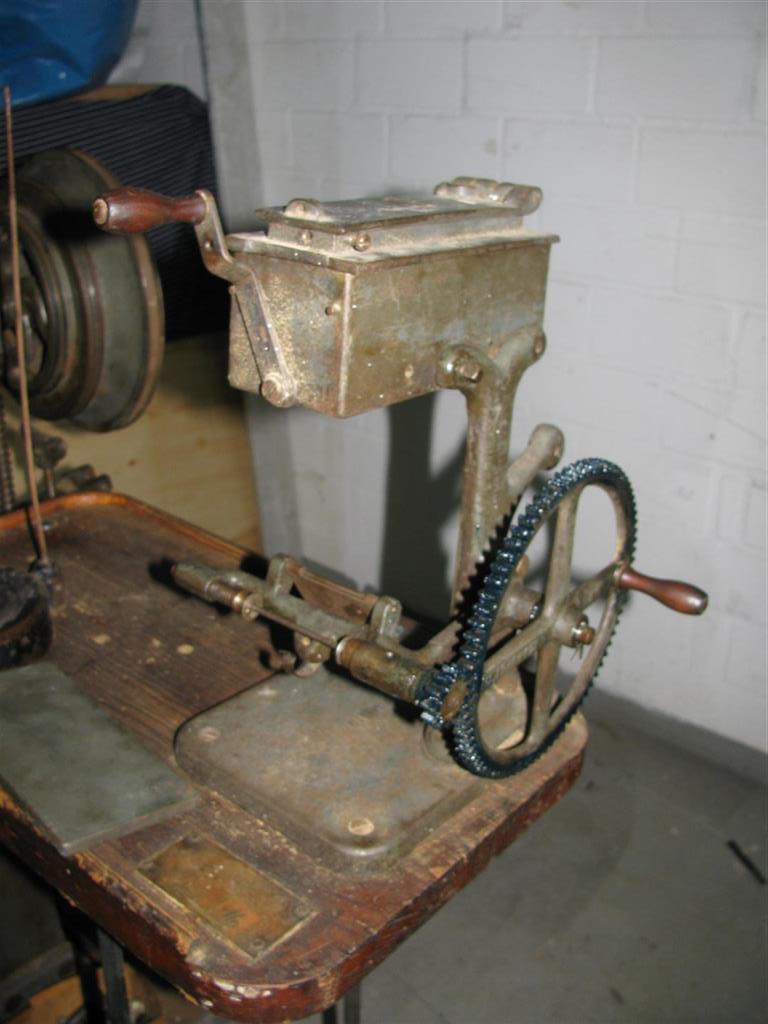

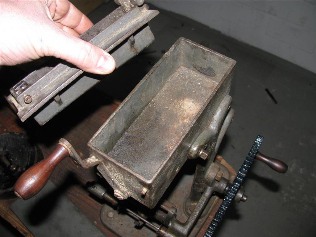

Another thing to mention explicitly is that you've got a complete bobbin winder there, including the top wax pot. Do not let that go! They are rare as hen's teeth and worth quite a lot.

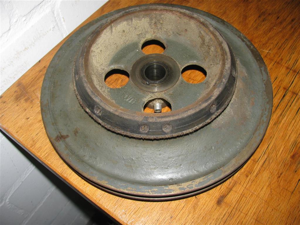

I'm curious about the pedal on the left hand side of the stand. I would like to see photos of that when it's assembled to see what it does.

I just figured the left pedal is a clutch pedal. The machine once was motor driven. I have almost assembled everything but I´m not sure if the clutch system is complete.

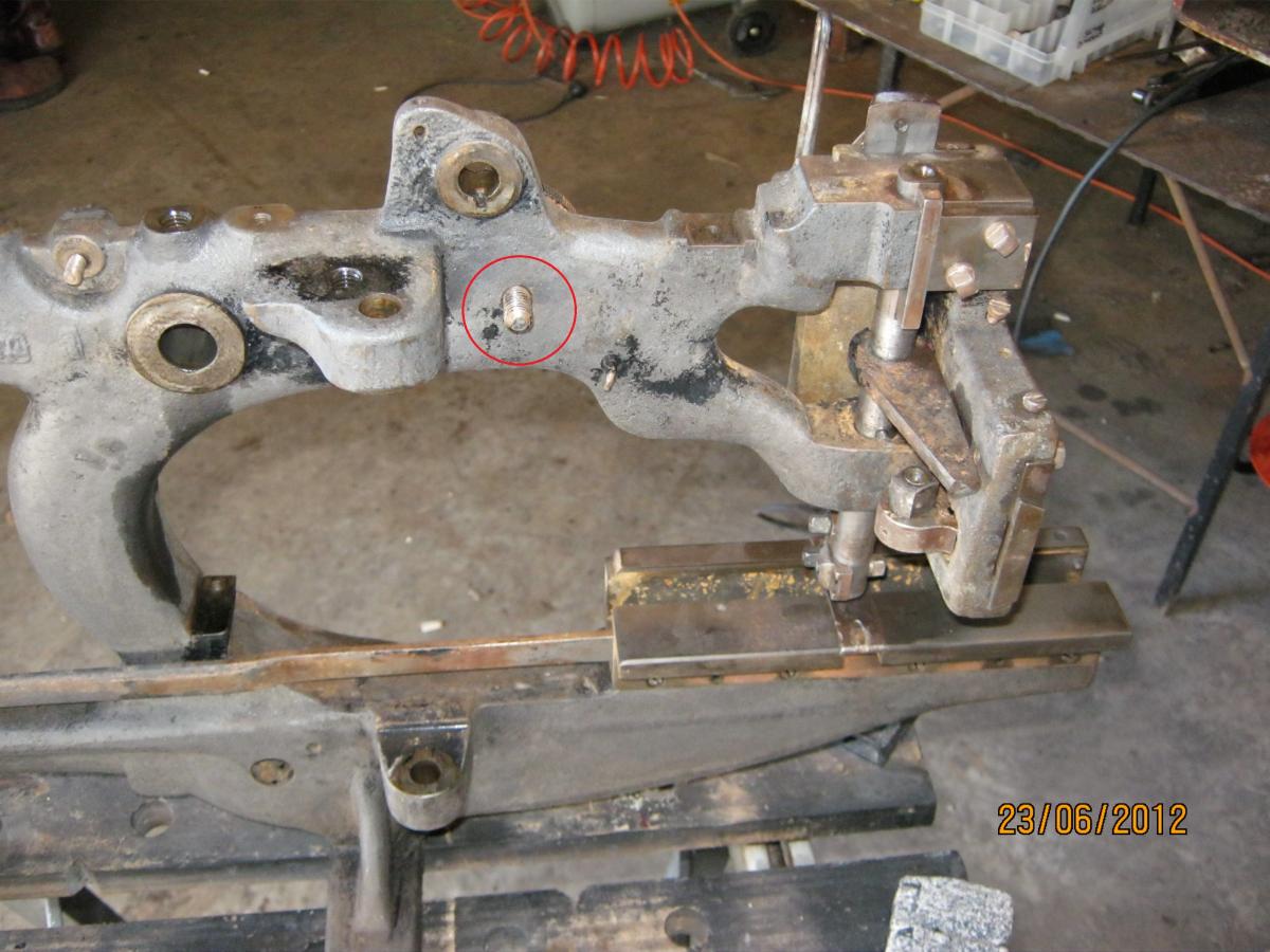

Cool machine!..nice set of feet as well ...and as Al ; said the winder is worth $$!!
I often end up [reluctantly] die grinding the bare castings - not surprising - the heavy coatings they used covered all the sins[ I'm referring to Japan finish here- though I have encountered factory filler- Singers/ Dania and others].
the point of doing it is that after putting so much time into a restoration- skimping on the basic work as we know is false economy.
HM6's are not too bad but always seem to have some rough parts and some pinholes in particular spots that WILL always stand out -and drive you nuts in not fixing it from the start..[pinholes hold oil which needs to be heated and bled out- heavy grade Singers seem to be quite bad with this - mainly the thick section castings which makes sense]
the last HM6 restored took almost as much time on the stand let alone the machine- reason was the state of the casting [shrunk back hollows , spue , uneven location in the casting box leaving steps in the cast- so on -so on]..I am redoing the livery and wasn't happy with it - not a big thing.

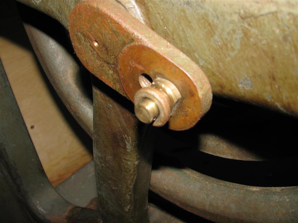

Hey Gordond - I already admired your machines. I stumbled over the pictures when I was googling for Pearson #6 pictures. Very nice machines - really really well done!!!! A Pearson w/o bobbin winder does not make much sense but seems most sell without it as it seems. I always loved these machine and never thought of finding one on this side of the pond. Seems I treated the easter bunny well last year. :)
Mine is missing the driving rod between the pedals and the short arm of the balance wheel on the stand. Were these rods made of wood or metal? Could you give me some measures like thickens, width, length and distance between the 2 holes...? That really would help me.

thanks!....Al was going to get a pick axe handle and cut it down for a drive rod [i'll probably do the same for a couple of machines that are missing them]...ie/. straight grain Hickory..pic in'c shows ~ 397mm centres..they are left hand thread bolts.. getting too late to start taking apart[everyone asleep] .but will take some measurements in the daytime
