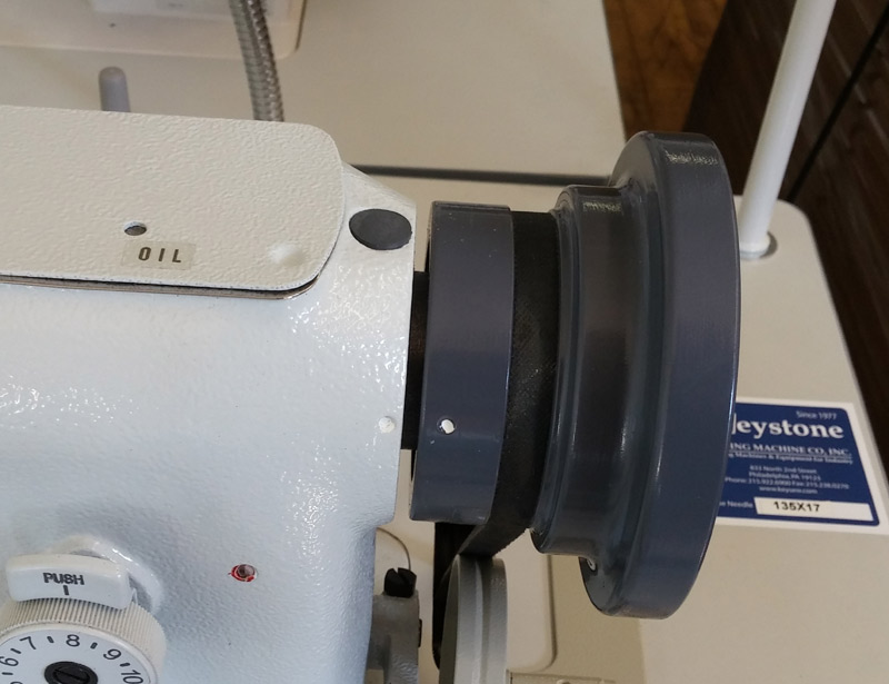

See attached, this is how handwheel should appear, with both white dots aligned to remove the bobbin. That's what these marks are for. They are fixed on the handwheel, and the handwheel is fixed by set screws on a v ditch and slot. Older 206RBs had the dot on the handwheel with an adjustable ring.
In addition, the feed dog carrier could be a hair too low, and impeding the bobbin case from coming out as well, but this is a sensitive adjustment that can easily be too high or too low.

Thank you Gregg. The white spot on the pulley was hidden by the upper belt guard. Now, it's been removed and I can see it clearly now.
