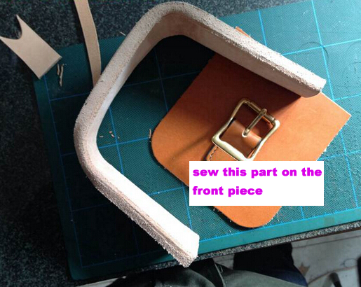

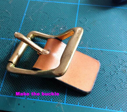

Members DANDTON Posted April 10, 2015 Members Report Posted April 10, 2015 Hi New to leather work and the forum and looking for some help and advice. I would like to make a bag similar to the one in this picture attached but can not figure out the best way to get the gusset to form the nice rounded corners and the correct technique to do it. A search on this forum and google has not been successful (wrong terms I knowing me), so apologies if its been asked before. I look forward to the help One of my guest change the construction a little and send me a tutorial, let me share you here Look at the pictures in the attachment, I named them as aaa bbb ccc ddd eee fff ggg hhh ggg, so you can follow the alphabet order as the steps. Quote The patterns and tools gold mine www.lzpattern.com www.leathercraftpattern.com
