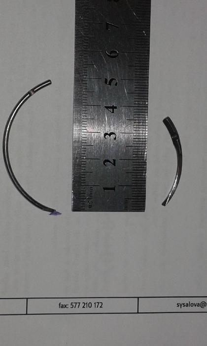

Need help with hook needles and awls for this machine. Machine wihout brand, producer unknown. Sizes of needles and awls are a little different than i bought from dealer. This system isn´t established in my country, but machine is it in good condition so i hope i got the necessary needles.
Needle on pic is broken, without point and hoko. But awl is ready
Thanks for your help in advance

This seems to be a RAFFLENBEUL sole stitcher. I think the model was MATADOR. I´m not sure but I guess it is the predecessor of the MS55 or MS200 sole stitcher.
I don´t know if it is using the same needles / awls as the the MS200 but you can buy MS200 needless here:
http://www.ebay.de/itm/RAFFLENBEUL-NADEL-UND-AHLE-SET-FUR-DIE-MS-50-MS-200-DURCH-NAHMASCHINE-/251908216399?pt=LH_DefaultDomain_77&hash=item3aa6e6564f
An here you can find a manual for the MS200
http://www.ebay.de/itm/Doppelmaschine-Rafflenbeul-Ms-200-/321604735948?pt=LH_DefaultDomain_77&hash=item4ae122d3cc
The manual could be helpful as the M200 looks a bit like your machine but I´m not 100% sure.
