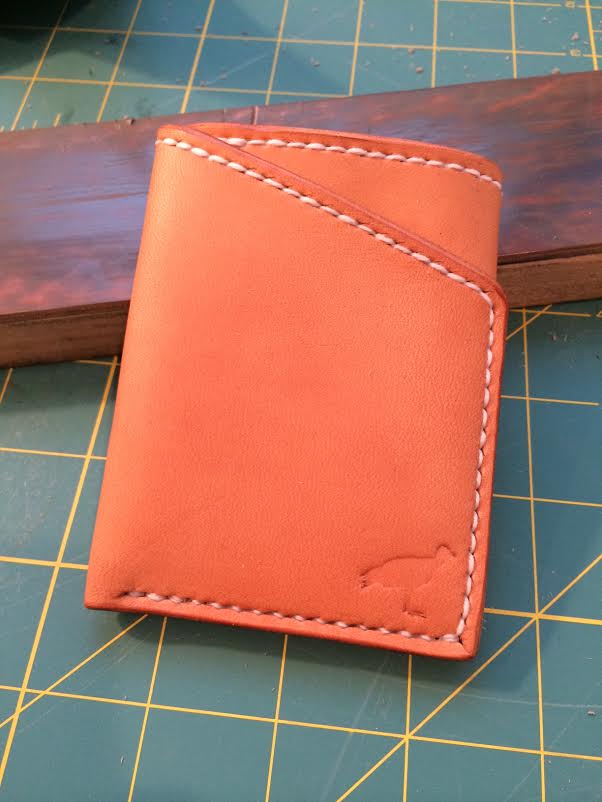

Members MudBugWill Posted May 22, 2015 Members Report Posted May 22, 2015 I have been using a concoction of 50% tallow, 25% lard, and 25% beeswax for some time now and it is amazing. It is a bit stiff, but put a thick layer on, hit it with the hair dryer, massage it in, and next thing you know you have rich leather and soft hands. I also throw in a bit of lanolin to the recipe. I use it on all my veg-tan leather, put it on my chapped lips. style my hair with it occasionally. and finish my Micarta knife handles with it. It is quite the potion. Hermann Oak Natural veg-tan before: After: (different wallet, same material) Quote
