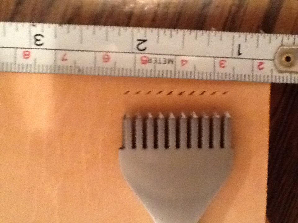

Members Tugadude Posted May 20, 2015 Members Report Posted May 20, 2015 I bought the 10 tooth model #88055-10. Would have bought a two tooth to go with it, but they don't make one. I did a watch band recently and 9 SPI was the result. Here's a pic to show the marks. This is the smallest spacing and the teeth are very skinny. I used very fine thread in comparison to what I generally use. Results were decent though. Quote

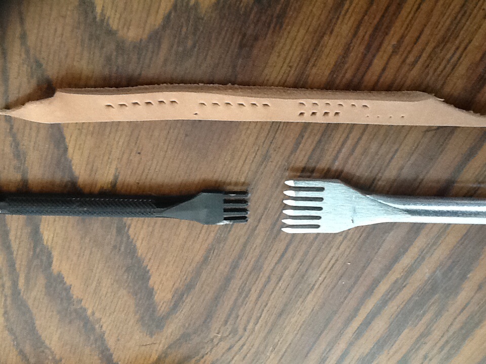

Members Tugadude Posted May 20, 2015 Members Report Posted May 20, 2015 (edited) I measured it at 6.5 SPI. The one on left is the Finesse from Springfield Leather. Edited May 20, 2015 by Tugadude Quote
Members Tugadude Posted May 20, 2015 Members Report Posted May 20, 2015 In the photo above, the picture flips when you click on it, so black is on left. The black one is the Tandy. The proline are different than the one tugadude posted. I just have one. The 5mm one. I never use it. They aren't the best quality so I wouldn't recommend. The new ones (that tugadude posted) are much better quality but I don't like the design that much. I'd take a look at the japanese brands if I were you. I get so confused! They both have Pro in the name, should have compared model #. Quote
