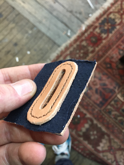

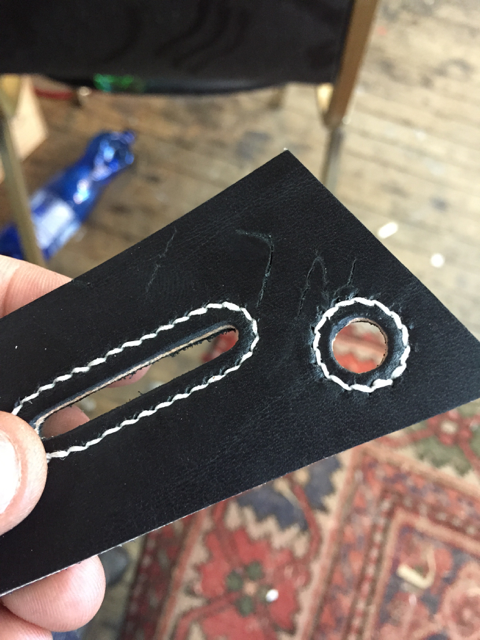

I dare say that Nuttish's example of the stitched hole looks more traditional, or refined (as in "classy") than grommets or eyelets. For fine leather goods like attache cases or other bespoke goods I would suggest that approach.Where ruggedness, utility, and economy (of manufacturing effort), the grommet or eyelet might be more common. Either approach can work, depending on the application.I see fewer grommets/eyelets in fine dress shoes but lots of them in work boots.
Duh. Forgot you have to anchor your lining. Pardon this rough and peanut shaped comp.
