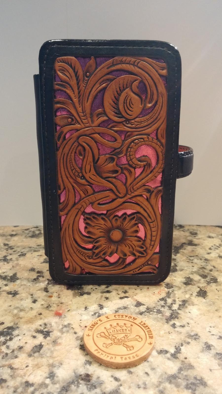

King's X Report post Posted June 10, 2015 I agree.....you want a highlight use Fiebings Antique gel. The oil dye will only cover the leather. It will not highlight like some Eco Flo products. If our tips do not work, try posting a picture. Here is my latest highlighted project using the Antique Gel and oil dye leather. Quote Share this post Link to post Share on other sites

King's X Report post Posted June 10, 2015 I dye my project areas that I want to color. Leave those areas that I want to highlight. Once the dye dries, especially oil dyes, you have to light buff the project to remove any residue before moving forward. At this point, if I want to, I will apply oil to the entire project. Once it soaks in, I will apply a resist product. I have used many, but I seem to have best results with Clear Lac from Springfield Leather or Bee's Natural RTC finish. Once this dries, I will apply my antique gel product......when it dries, I will use a coat of Tan Coat to remove the excess gell and coat the project. I do agree that you should always test any product before you use it. Good luck! Quote Share this post Link to post Share on other sites
