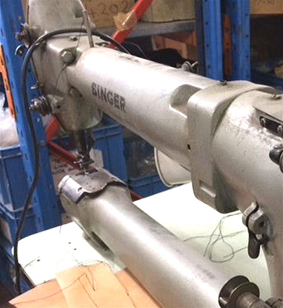

Is this not a 133k 13 ?

You wrote 133K13 - and this is a darning machine.
Post some pictures if you are unsure.

I've posted a photo in a previous post..
I had a quick go and it punched through a single layer of 3.2 veg but needs a service so not seen it stitch properly. It had a walking foot too
Maybe I have the wrong machine code ??

Seems it has a feeding mechanism and a walking foot - Looks like a 133K17 but not 100% sure - If you have the space then I´d choose the 133K. I´d test sew either machine before you buy one of them

post-31854-0-34133400-1435407120_thumb.j
Both that same price £1000, my main consideration is it being able to sew through thick veg without issue, the advantage of the 133k is its long arm as I build leather armour.

The advantage of the 45K89 is that it has reverse (the 133K has no reverse) and has a heavier handwheel which gives the needle more puch but the long arm of the 133K is also quite nice and as CowboyBob said there are more 133K (or 132K) parts are availlable than for the 45K.
Check with College Sewing UK - they have a good ranke of parts.
At the end it is your decision.
