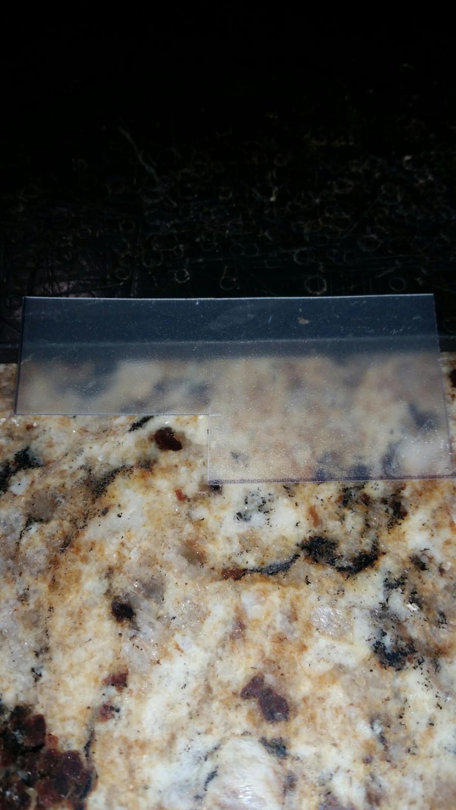

Members TomG Posted July 28, 2015 Members Report Posted July 28, 2015 After reading tons of threads and sites on the servo motor mod, and not being able to get a smooth response myself, I did some experimenting. I made a graphic with 3 different black to white gradients. 15, 25 and 30% from the edge. Mine motor worked best with the 30% gradient. I used some thin, translucent plastic from one of the dollar store cutting pad (abt 1mm), about the width of the paddle blade. I printed the gradient on photo, best quality mode. I then used doublesided tape to tape the gradient to the plastic and trimmed. I slid the strip into the photo interrupter and trimmed the strip so that the point at which the motor started was just inside the edge of the strip. I then tape the strip at right angles across the paddle. Setting the motor speed to 10 and the start speed to 9, I was able to adjust the strip and paddle for a smooth, full-range control. I'm attaching some photos and a JPG of the gradient. Hope it helps some of you. Quote Tom Gregory Legacy Leathercraft www.legacyleathercraft.com www.etsy.com/shop/legacyleathercraft
Uwe Posted July 29, 2015 Report Posted July 29, 2015 So you print the gradient on normal paper and then attach it to the clear plastic just for stiffness, right? Quote Uwe (pronounced "OOH-vuh" ) Links: Videos
Members TomG Posted July 29, 2015 Author Members Report Posted July 29, 2015 Yup. And I just noticed that I didn't upload the gradient. Here you go. Quote Tom Gregory Legacy Leathercraft www.legacyleathercraft.com www.etsy.com/shop/legacyleathercraft
