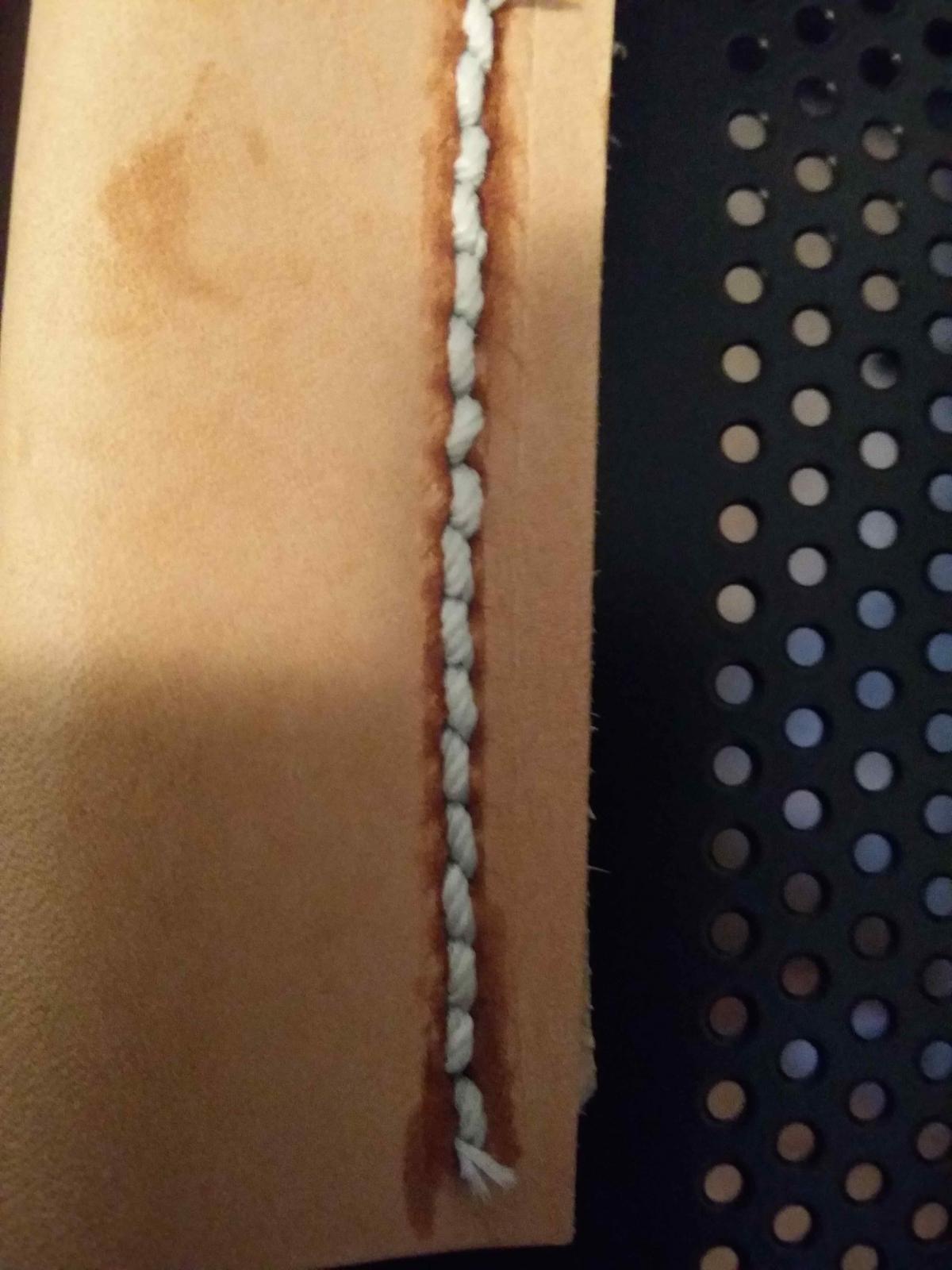

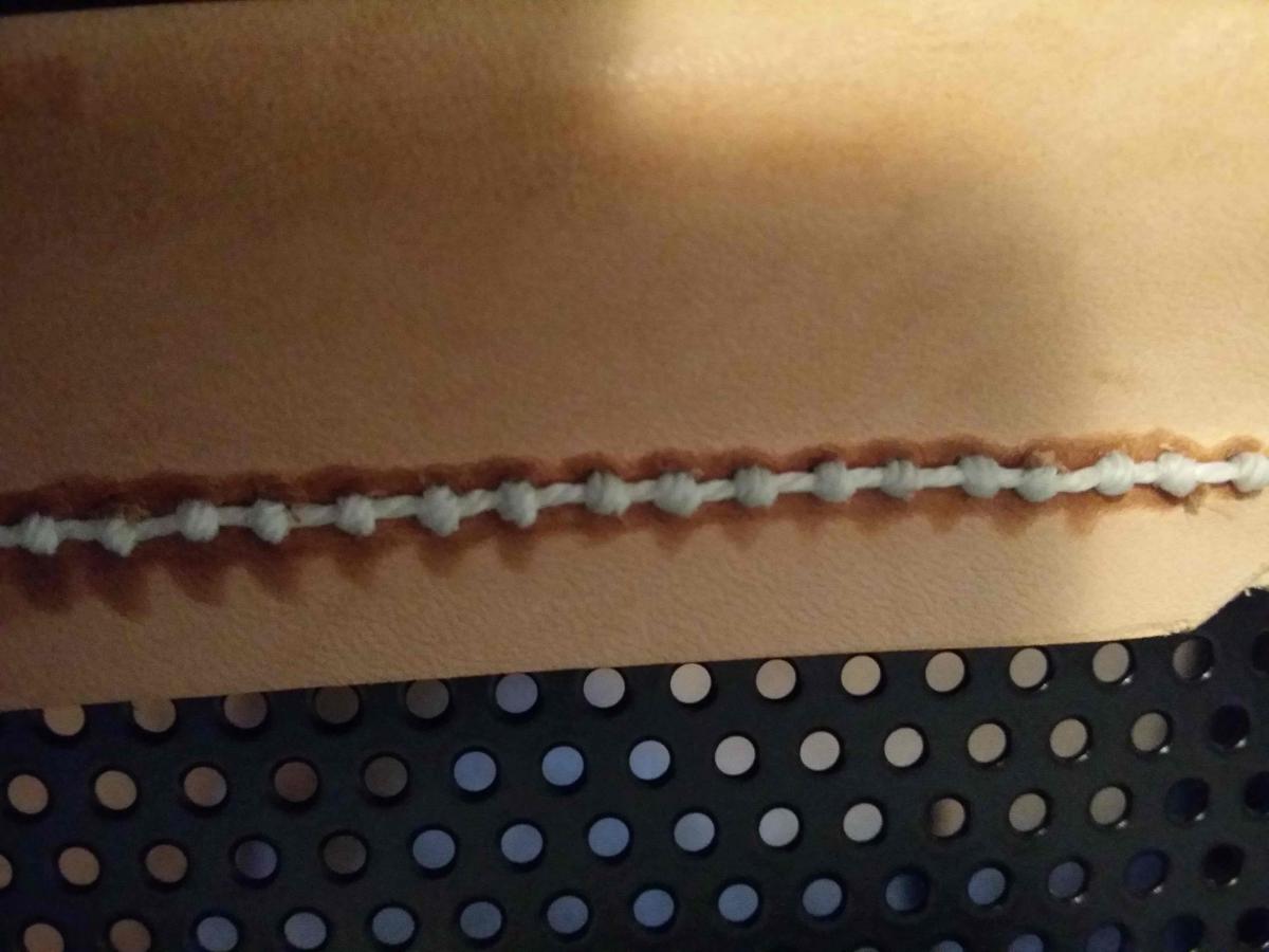

Members cgleathercraft Posted September 11, 2015 Members Report Posted September 11, 2015 (edited) Seem to be having a tension problem when sewing approx 12oz. Some thicker stuff doesn't have much of an issue but does every once in a while. Top: Bottom: I also break the top thread every now an then. I've ran it slowly and it seems to be taking up too quickly and getting pinched between the bobbin housing on take up. I can get by with running it by hand but any faster than that will cause too much stress on the thread an pop it after a few stitches. Edited September 11, 2015 by cgleathercraft Quote

Members dikman Posted September 12, 2015 Members Report Posted September 12, 2015 Based on what I've gleaned thus far in my sewing machine journey, my first thoughts on seeing the bottom photo are - bobbin tension too high, upper tension too low or needle not big enough (hole not big enough to pull the bottom thread through). I'm curious to hear if my reasoning is right. Quote
Members cgleathercraft Posted September 12, 2015 Author Members Report Posted September 12, 2015 Thread, needle, and awl sizes are all as recommended in the user manual. The bobbin tension is loose enough i fear the screw might work itself out while stitching. No luck yet...still playing around with it. Quote
