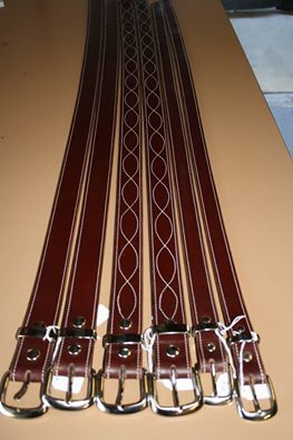

HI All, actually the Cowboy CB3200 is rated at 5/8' rather than 1/2" and is not a clone of the Juki TSC 441, it is an inhouse design and uses some Juki and Adler parts. That being the case it is not quite the same when doing the main timing or the reverse timing... there are other more obvious differences such as the bobbin winder not being on the main body of the machine and so on.
When we (Australia's Cowboy Leather Machines) put this machine to the public we mate them with a range of tables.... it could be the cut away one, a pedestal or an overhang style table. You can also have a clutch or servo motor, however nearly 100% of buyers will opt for the speed reducer. They also come with the special foot and plate pack, which means you get the blanket foot set, the double toe leather foot, left and right toes, left and right dogleg toes, smooth dog and plate as well as the stirrup and holster plates.
This machine is an excellent all rounder, but we are finding back here in Australia that it excels in the belt making and bag making trades.
I've attached a couple of photos from Steve Kemp and Doug Johnston.
post-19343-0-52429800-1442832761_thumb.j
post-19343-0-26545500-1442832800_thumb.j
