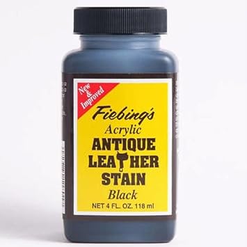

additionally i found and other paint ,that write on its label that it is antique stain.
( http://ecx.images-amazon.com/images/I/41EcGYyXU2L._SY355_.jpg )
Iam confused because i don't know what exactly each of these products do and the most important if they work well with my chrome , veg tanned leathers that i have.

But I found one product at on its label is written stain and antique:
What is exctly this product?Which is the difference between this one and stains and antique paste?
That product will color the leather the color onthe label, and it will fill in low spots with a dark paste to highlight them. It will not give you the look of the watch straps you pictured
