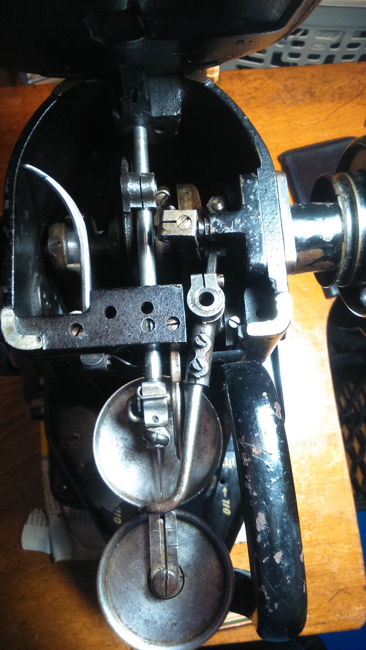

Members TinkerTailor Posted November 15, 2015 Members Report Posted November 15, 2015 Here is a page of parts lists for most of the 46k variants. There are alot of different 46k machines, which subclass is yours? Yours looks like a 46k15 from the picture. This page list a needle size of Needle = canu 08:65 - system 459 r - 1567 - SY 6520. Hope this helps. TT Quote "If nobody shares what they know, we will eventually all know nothing." "There is no adventure in letting fear and common sense be your guide"
alexitbe Posted November 15, 2015 Author Report Posted November 15, 2015 (edited) Hi Tinker Taylor Thank you for taking the time to look at my problem and the links(last one I have not seen before). It looks remarkably like the 46k24 in your link. Maybe its a later replacement for it? The recommended 459r needles are 3.5 mm longer to the hole att 33.5mm and have a slighlty larger shank diamter of 1.40 mm. Will this not be too much? My sewing machine is a 46k45. It is a double thread machine. I just looked at the partslist very carefully and don't know how I missed it before as I ahve looked at it a 100 times. The official needle system is: 215x5 in sizes 18,19&21. I think the needle that came with the machine is correct because it has Simanco 18 written on it. I measured the needle diameter and its 0.8 mm. However, this does not match the singer conversion table which says size 18 should be 110 nm. Anyway I do have a packet of 215x15 needles and the shank diameter is correct at 1.0 mm, the distance to the hole is 27.9mm. Interestingly this is the same distance as the Bonis 292 for the older machines (canu 01:30ma), aka ns292. This is also the same length as for 46x5 singer system, which is for some 46k fur machines and I bought hoping it would fit. Does anyone know an alternative to 215x5 system? A table of Singer 46k overseamers and their recommended needle size. The numbers I give of those that I have measured. There will be some error in these. machine needle system length to hole shank diameter total length K15 46x3 K30 46x5 K37 215x9 or 88x1 K38 215x13 K39 46x5 27.9 mm 0.96 mm 34mm K45 215x5 30.0 mm 1.08 mm K46 215x15 27.9 mm 0.98 mm 32.4 K48 215x17 K50, K51 16x21 K52 215x21 K54 46x5 Cheers ALex Edited November 15, 2015 by alexitbe Quote
