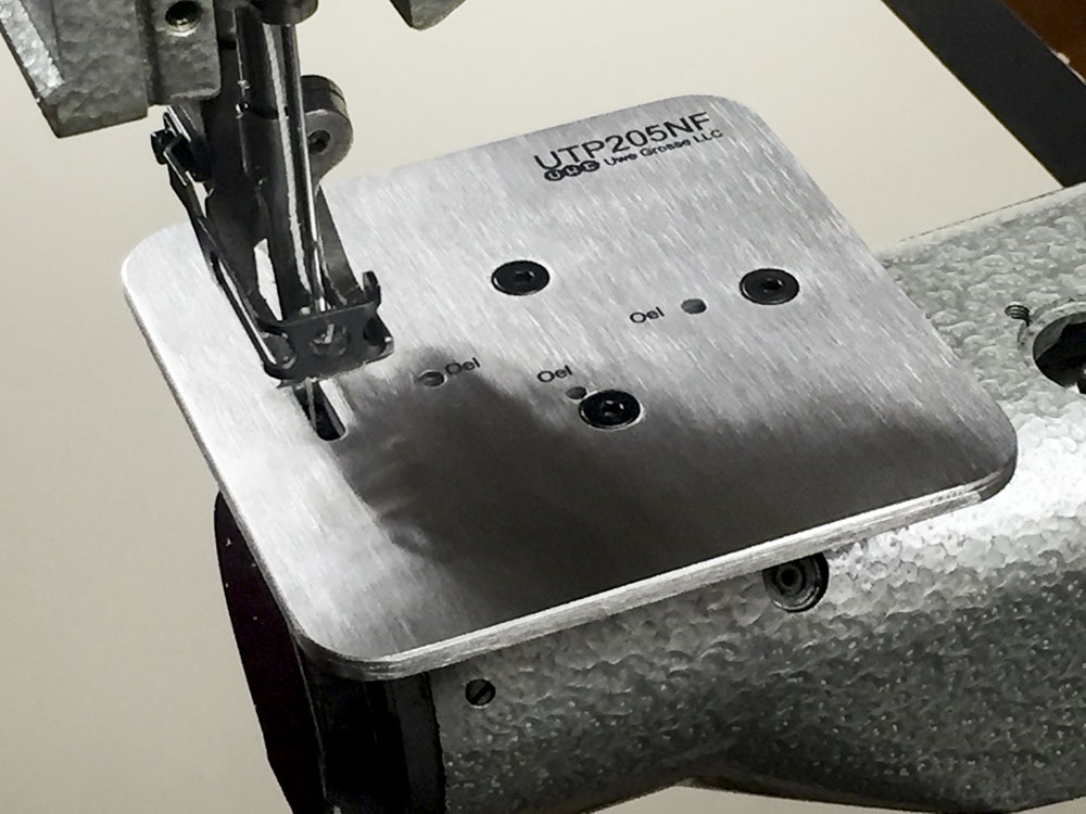

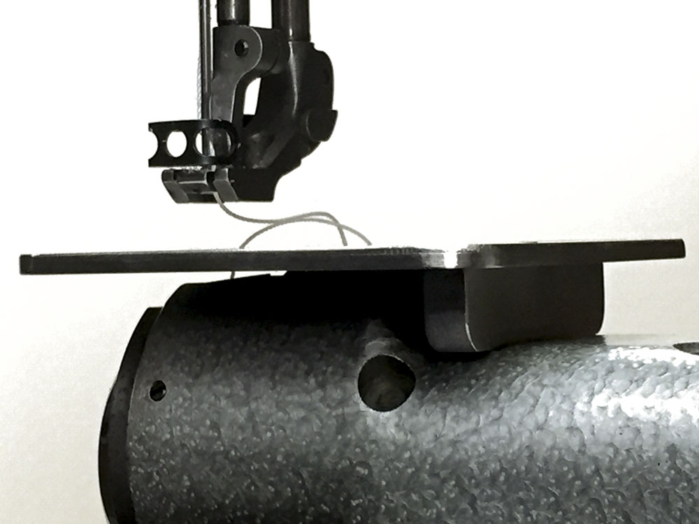

I made this little platform to allow using the Durkopp Adler 205-370 in Needle+Upper feed mode rather than compound feed. Turning off (removing) the bottom feed dog can help minimize marks on the bottom of the workpiece for certain sewing operations. The idea popped into my head while contemplating a topic in another thread about working with veg tan and prefinished leather. Here are some pictures of the platform:

Uwe, will your new needle platform work with this style of roller guide? On the 205-374 the guide is on the cylinder arm and folds down the side of the arm.

I had noticed that guide in one of other posts. It's a neat and unusual edge guide solution.
It seems to me like that style edge guide would not interfere with installing the needle feed platform (I'm pretty sure that it would interfere with installing the flatbed table attachment, however.)
But I'm quite certain that you would not be able to USE that style edge guide while the needle feed platform is installed. The guide wouldn't be able to flip up and into position. In order to use an edge guide with the needle feed platform installed you'd need a suspending edge guide that comes down from above (like the KG-867). A suspending style edge guide would work with both the needle feed platform and the flatbed table attachment.

Thanks, that is what I suspected but thought I should ask.
