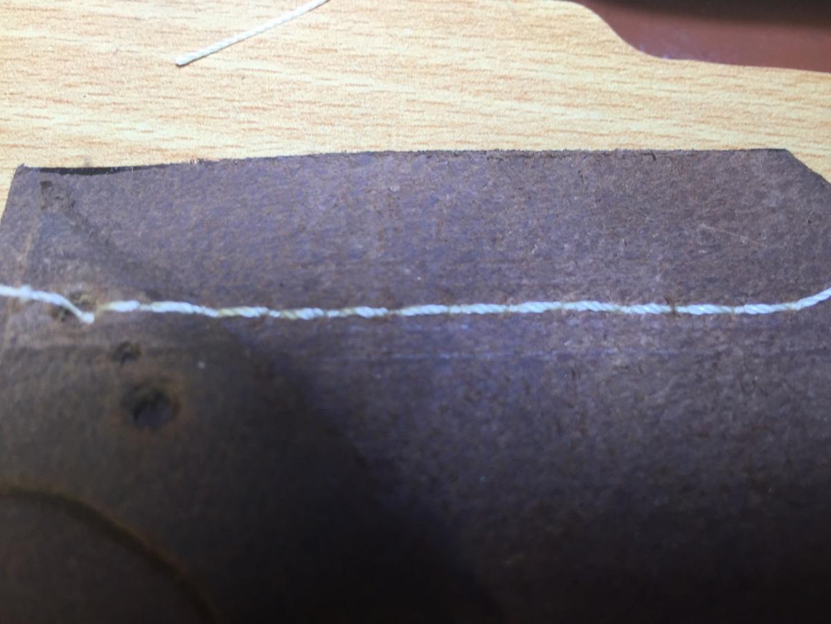

Members chapelstone Posted December 23, 2015 Members Report Posted December 23, 2015 I have a class 3 machine and love it. I am new at this and have not changed any settings since I bought the machine. I changed from 207 thread with a 23 needle to 138 thread to a 22 needle. At first the knots were showing at the top and the bottom looked good. I adjusted the tension like the book said. Now the top looks good and the knots are showing on the bottom. Any suggestions, I am afraid to change too much. Quote C. Norman McGlohon Chapel Stone, LLC Custom Leather Works
Members Oakley Posted December 23, 2015 Members Report Posted December 23, 2015 I think you loosened the upper thread tension a little bit too much, try to increase it step by step. If that doesn't work you could decrease the lower thread tension a bit, but I always try to use the upper thread tension first. Quote
Members chapelstone Posted December 23, 2015 Author Members Report Posted December 23, 2015 Thanks, tightening the upper tension did it. I was adjusting them both at the same time. Quote C. Norman McGlohon Chapel Stone, LLC Custom Leather Works
