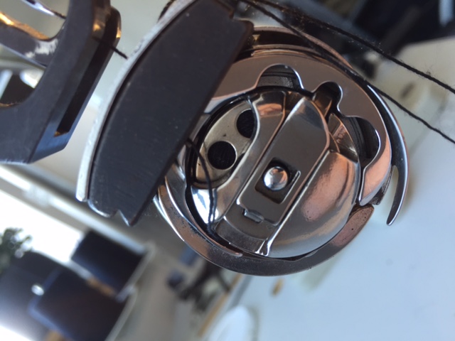

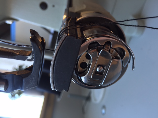

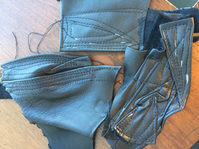

Members pokerinot Posted March 6, 2016 Author Members Report Posted March 6, 2016 Hi everyone, I'm finally updating now that I've figured out how to add photos (one of the jacket almost done and one of the finished state with accessories)The machine has been okaaayyy... I'm not completely thrilled. I got through most of the jacket with no problems but on the FINAL seam -a topstitch that closed the collar to the rest it basically reverted to skippy style. I tried that seam a few times (making a perforated mess of the leather --luckily it is hidden when worn but UGH) and then just went to my work to close it up on my machine there, which sewed it without hesitation and very predictably. I also have to sit down with the machine and have a stern talking-to about my expectations re: zipper tape. It skipped stitches EVERY SINGLE TIME I sewed crossways on zipper tape.Since then, I have sewn two bags with no problems (crossed fingers) but I have two more jackets coming up soon and I really need to sort out it's hesitation to properly sew uneven and multiple layers! That is part of sewing! And zippers! Lastly, I am attaching a photo of the bobbin case... It seems weird that there's a thread crossing the outside of it and I can't seem to make it go away... I have a feeling this is part of the problem. I've tried loading the bobbin with the thread in "p" and "q" orientations. When I got the machine back from Techsew the bobbin thread was not doing this. Am I loading it wrong? Bonus: visual evidence of my frustration with skipped stitches highlighted! Quote
Members pokerinot Posted March 6, 2016 Author Members Report Posted March 6, 2016 Here's a better picture of the bobbin -I pulled the thread a little to make it more visible Quote
Moderator Wizcrafts Posted March 6, 2016 Moderator Report Posted March 6, 2016 (edited) I am not going to address any of the mechanical problems your machine may or may not have. Rather, I am going to pass on my own solutions to similar problems I encounter when I sew jackets and install zippers that have double sided leather tape. Increase the alternating height of the feet to the maximum before the bottom of the needlebar hits the top of the inside foot, at the height of the thick collar seams. Increase the pressure spring action of the outside presser foot. You need to force the spongy layers of garment leather down all the way. Switch to titanium coated system 135x16 needles. Titanium resists the glue on the tape clogging the eye. Use a size larger needle than you think is necessary. The larger eye lets the thread move a little easier through the goop. Increase the travel on the check spring to keep tension of the top thread until the needle completely pierces the material. Edited March 6, 2016 by Wizcrafts Quote
Moderator Wizcrafts Posted March 6, 2016 Moderator Report Posted March 6, 2016 Of the above listed items, #1 is important when you change height from the collar and other major seams to lesser thicknesses. The outer foot stays up on the higher layer and if the inside foot doesn't have enough alternating distance, the bottom layer will lift with the ascending needle and skip stitches. Quote
Members pokerinot Posted May 15, 2016 Author Members Report Posted May 15, 2016 Thank you again, Wizcrafts! I am doing this dance all over again and your comments are very helpful. Do you or anyone have an explaination on how to increase the alternating height of the feet and how high they should be lifting? The outer foot lifts quite high but the inside one doesn't. Also, I mentioned before the weird feeling that the material was being pushed forward as the needle went in. Techsew said they looked at it but I just took the face plates off and watched it and the feed dog very clearly shifts forward when the needle has just pierced the leather. Could this contribute to skipping stitches? I've backed off on the inside presser foot pressure because it seems like the pressure causes the shift forward (doesn't move when the foot is raised) but that didn't really work. Also the bobbin housing is making a god-awful racket so there's that too..... Anyway, long day, long rant. Thanks to anyone who is still reading Quote
Moderator Wizcrafts Posted May 15, 2016 Moderator Report Posted May 15, 2016 Pokeriknot; It appears your machine is in need of expert repair. Take, or ship it to an industrial sewing machine dealer. If it is under warranty, send it to the dealership who sold it to you. If you dink with it and make it worse, the cost of dealer repairs will go way up. Quote
