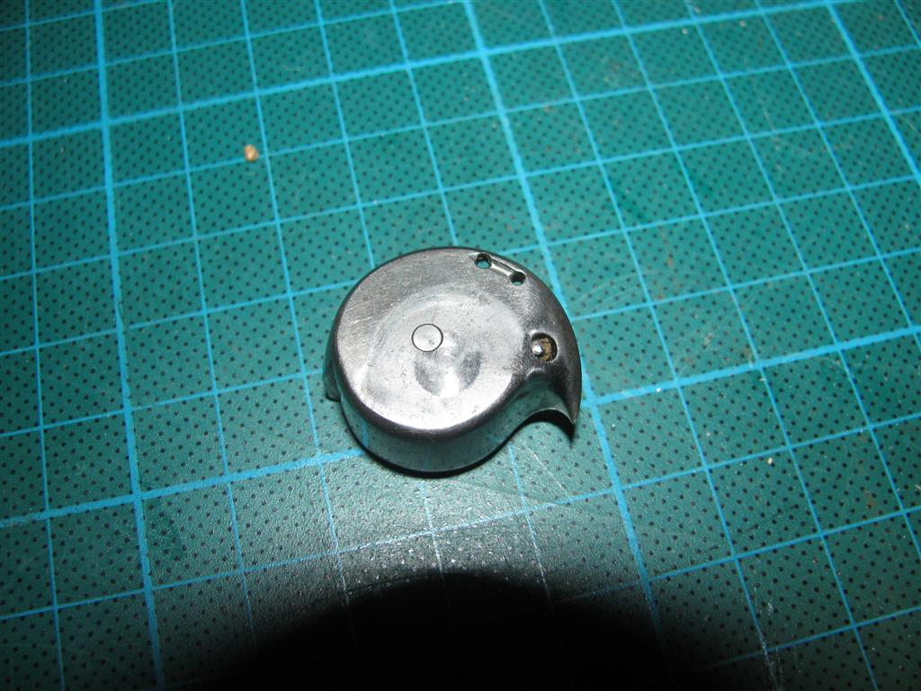

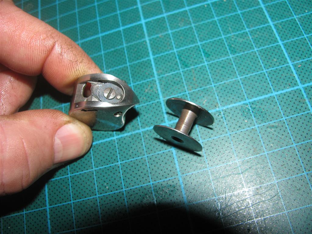

Members Constabulary Posted February 16, 2016 Members Report Posted February 16, 2016 I probably have a shuttle hook and bobbin but I´m not 100% sure if it is the same. Maybe LW member SHOEPATCHER will jump in here - he for sure knows more. Quote ~ Keep "OLD CAST IRON" alive - it´s worth it ~ Machines in use: - Singer 111G156 - Singer 307G2 - Singer 29K71 - Singer 212G141 - Singer 45D91 - Singer 132K6 - Singer 108W20 - Singer 51WSV2 - Singer 143W2
Members shoepatcher Posted February 16, 2016 Members Report Posted February 16, 2016 (edited) C, That looks like the right one. Sometimes very hard to tell if that is the correct shuttle. I assume you checked it in the machine by hand? Does the bobbin fit? get me a few more pics of the old one from top, bottom and side view where the tension spring is. I like the machine. You going to restore it? glenn Edited February 16, 2016 by shoepatcher Quote

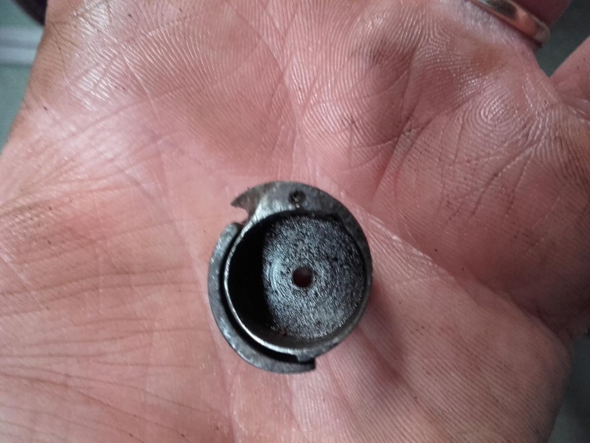

Members shoepatcher Posted February 17, 2016 Members Report Posted February 17, 2016 Lukitustura, I need to see more pics of the shuttle hook and bobbin before I can tell you if the Hook that Constabulary has will work. Also, more pics of the machine in general. I have a few of these machines in my garage that will be rebuilt in the future. Seeing the hook and bobbin will tell me more about it. glenn Quote

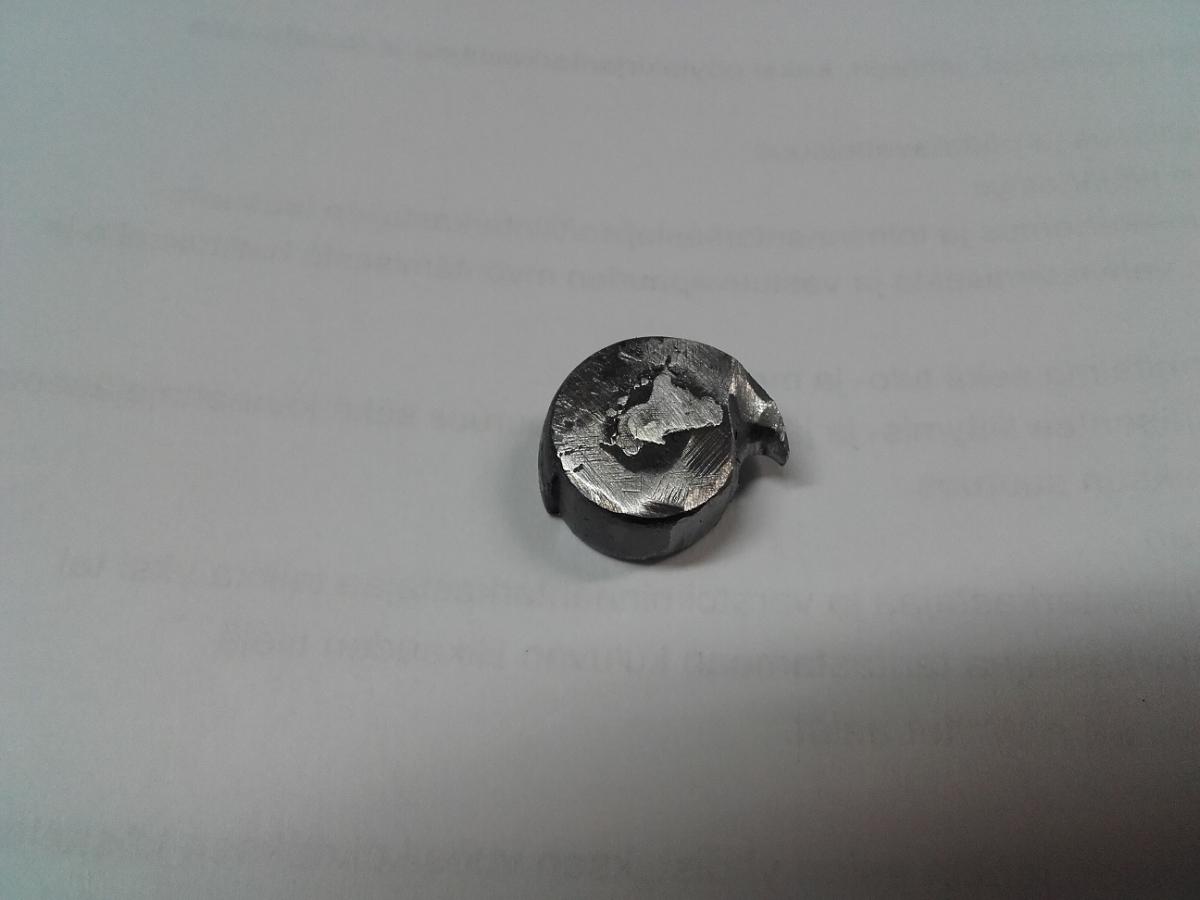

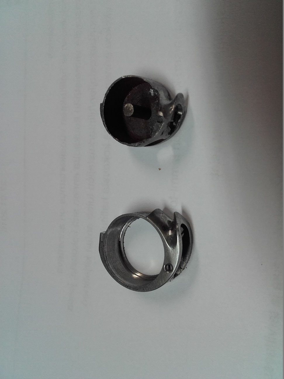

Members Lukitusturva Posted February 18, 2016 Author Members Report Posted February 18, 2016 singer is next Quote
Members shoepatcher Posted February 19, 2016 Members Report Posted February 19, 2016 Wow, That is one worn out hook!!!. It has been repaired a number of times so that the original is almost unknown. Any idea on the height and width of the bobbin in mm.? This also could be a hook someone made. It is that rough. glenn Quote
