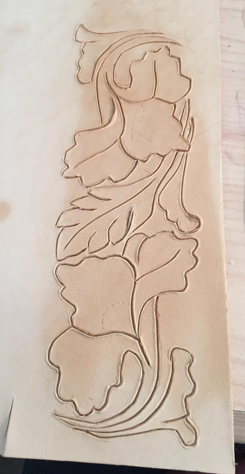

Hello all,
I tried today using a swivel knife for the first time.
I was left handed, but since the strokes I adapted to use my right hand.
All I can say is it is not as people seem.
Apart from my shaking hand I had few good part...but more bad ones.
I admit my swivel knife I not expensive, and I think the blade is sub standard.
Stopped with jewels rouge, but the edge went dull quickly.
Cased the leather like I read on this forum.
I must admit, it was very relaxing.
Any hints tips etc. I appreciate them all...even if it look bad to you...I can take lol
Thank for viewing.
Btw the work was sponged after, just incase you wondered.
ATB
Brian

I believe you might need to sharpen your blade before you strop for use. The depth of your cuts look better than my first cuts. I would suggest some practice before you start putting pen to paper. This will help you control the shaking (nerves) and cut depth and length. Try to remember that your cuts should start out deep and fade to barely cutting ......It will will give it more of a transition look.
I have attached an easy pattern for practice from a previous Leather Crafters & Saddler's Journal.

Sharpen your knife. Look closely at the very tip, it should be very pointed and not blunt. Let your leather dry just a little more, it was likely a little damp. Your depth of cuts looks good, rule of thumb is the deepest cuts are half the depth of the leather. Do not tip your knife left or right when turning, that is what causes the feathered areas on the corners.

In addition to the good comments above, I would say work on keeping your knife straight and not leaning. I can see some cuts that were cut at an angle and not square with the leather. Those slanted cuts will not look nearly as good as straight cuts when beveled.

do mean cut flat with the blade?, I was using the edge of the blade, not flat!!

Hello all,
well I tried king's x design..
bad enough using my new stylus today...shakes all over lol.
I think apart getting the leather wet enough...the crap blade, my lack of experience, using my wrong hand...(excuses excuses!)
Back on it again in a few moments.
ATB
Brian
