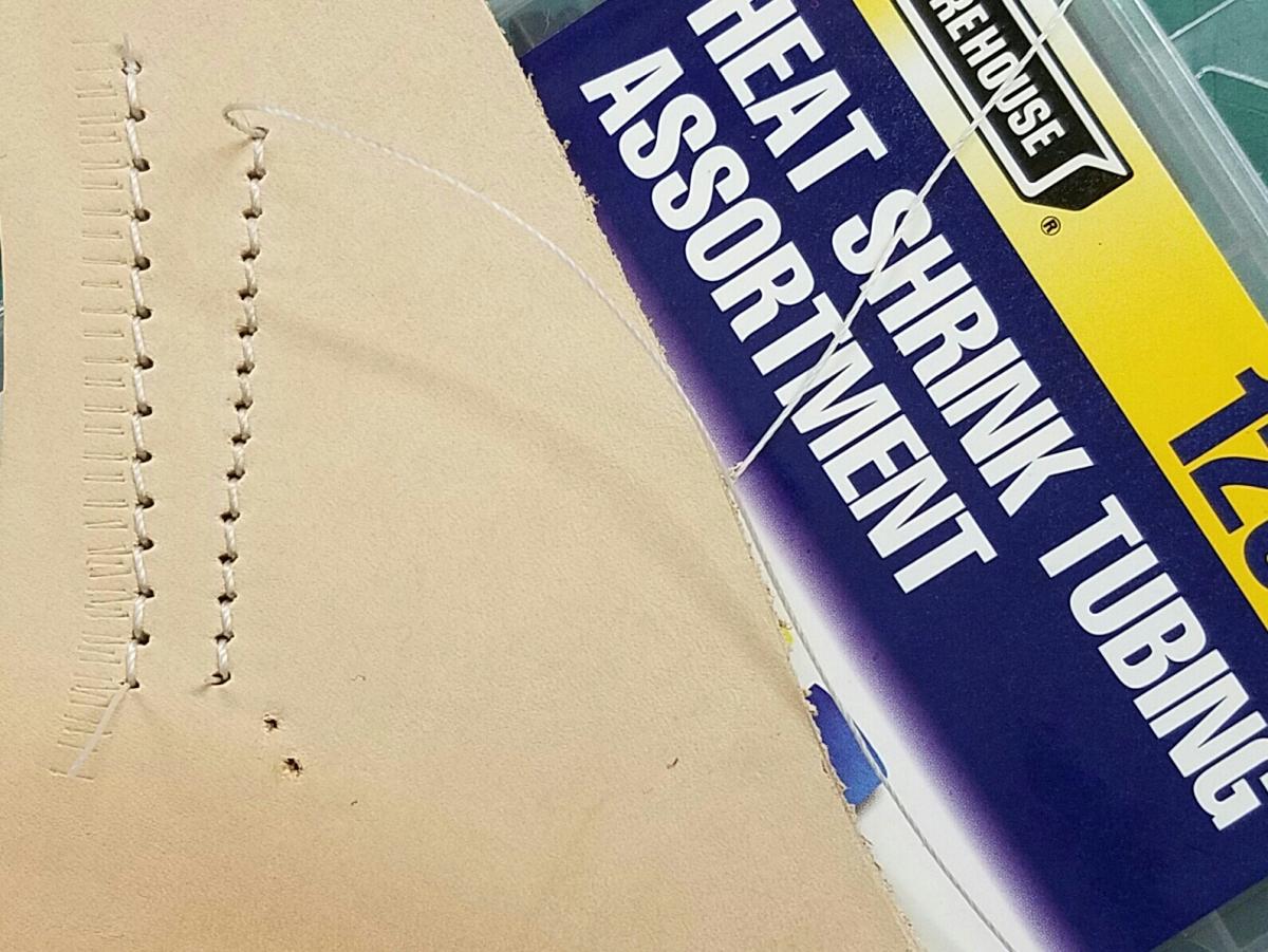

Here's the stitches with 138 ultra Dee 16oz. White
post-70995-0-40549400-1458168360_thumb.j

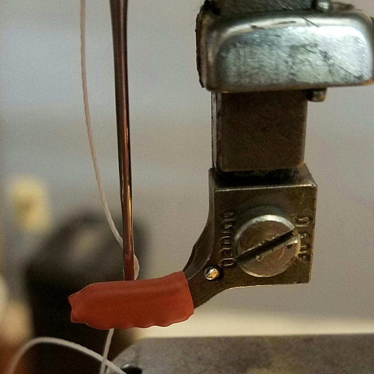

Ok, I had some heat shrink tubing and I must say that was a freaking stroke of genius! The marks are still there but very slight now and after I wet form my holsters I'm pretty sure they will not even be noticeable. It did however increase the stitches per inch.
post-70995-0-90390600-1458172176_thumb.j
post-70995-0-09511400-1458172559_thumb.j

Having seen how well Constabulary's idea of heat shrink tubing works, and how much less messy and simple it is than my idea of rubber solution boots, I am impressed ( by the lack of impressions on the veg tan ) and my hat is off ;)
