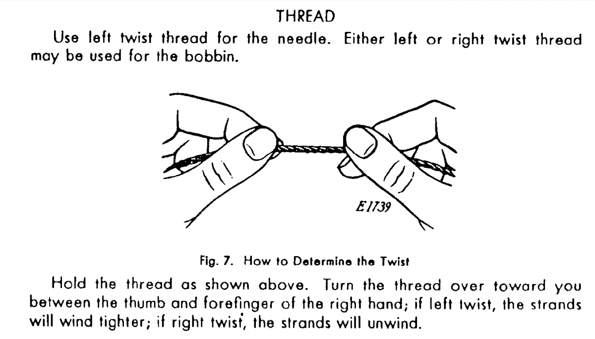

Uwe Posted March 19, 2016 Report Posted March 19, 2016 Is that thread some oddball opposite twist thread from a bargain bin? It looks a little like it's unraveling as you sew. Just about every vintage sewing manual has this diagram on how the thread should twist: Some specialty threads twist the opposite way and they often end up in bargain bins. Quote Uwe (pronounced "OOH-vuh" ) Links: Videos
Members Mira Design Group Posted March 19, 2016 Author Members Report Posted March 19, 2016 Wiz and Eric, I was able to get the assembly out. Cleaned it up and set it up as suggested. tried a few more stitches and it sewed great. However, as you said Wiiz, when I tried heavier material the problems came back. I guess it maybe time to start hustling some more so I can upgrade to a different machine. Unless I can find parts for this one. Still at a loss on where to order them as I can't find any info for this thing. What i have noticed is that some of my extra parts from the Union Special 61400A fit. (Bobbin and holder). The only reason I have been using this more is that it has a reverse and my Union Special doesn't. Uwe, I was wondering the same thing at first. I used the picture you posted and it looks to be the recommended left twist thread. Quote Currently using the following machines: Adler 30-10, Union Special, and New Home Industrial Machines. Trying to learn as much as I can about each one so I can use them to their potential.
