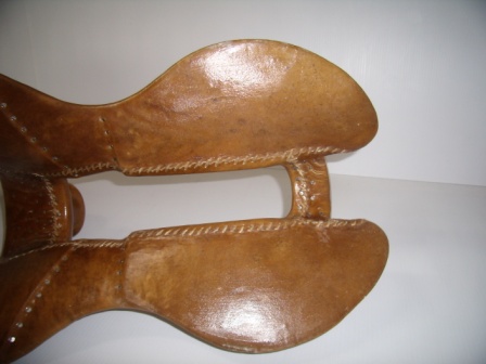

Contributing Member Denise Posted January 8, 2009 Contributing Member Report Posted January 8, 2009 Joanna, Sorry, didn't read back far enough again to see the type of saddle. I would be surprised if a flex tree were used in a saddle that might be used for roping. The reason I asked is that the shape of the back of the bars is so different from most traditional bars I have seen so I just wondered why and that thought came to mind. (Note to self: read and think before typing...) Just FYI in case you haven't had a chance to really look at a tree, here is a picture of a more typically shaped back bar pad. You can see it is not square but tapered so it is not as likely to interfere at the hip when turning as it would if it were more square. The rear part of the bar doesn't have enought angle on them. So all the pressure is on the inside of the bar. Mort, if the inside of a bar is sitting on the horse too heavily, it is because there is too much angle, not too little. Too little angle and the outside edges dig in. Quote

Moderator bruce johnson Posted January 8, 2009 Moderator Report Posted January 8, 2009 Traveler, I think I am getting closer in my mind. It doesn't answer one question, but answers a whole lot more. I was wondering if the skirts are held together or in place from the bottom under the cantle gullet. What this picture does tell me is - pocketed bars, loose strings, and gives me a frame of reference for just how thick that pad might be. With minimal blocking, those bars don't have a place to "set into" all the way around. The skirts are held up to the bars by those pockets sewn to the skirts over the bar ends. If those pockets stretch in the least, don't fit tight to start with, or the stitching stretches - room for sliding around. I have dropped the skirts on some and found the rawhide worn or completely abraded off and the wood polished from dust and grit working in under there from that setup. There can be that much movement. A lot of guys do a good job of putting on pocketed bars. I can about bet these are hit and miss. The off string is loose. If it even went through the bars to start with, it isn't holding the skirts up to the bars now. I would wager with this saddle it is probably throught the rear jockey only. On the $500 specials, it might be through the leather concho only and nailed on. How thick is the pad? With your fingers and that edge of the skirts lifted now for reference, I am thinking 1-1/4"? Now my thoughts as to why this problem is getting worse as the horse is apparently improving. It has nothing to do with the horse. It has to do with the saddle breaking in, things stretching, and getting looser as time goes on. Quote Bruce Johnson Malachi 4:2 "the windshield's bigger than the mirror, somewhere west of Laramie" - Dave Stamey Vintage Refurbished And Selected New Leather Tools For Sale - www.brucejohnsonleather.com

Moderator bruce johnson Posted January 9, 2009 Moderator Report Posted January 9, 2009 Joanne, I agree with Blake. I wouldn't trash it or take a big hit on it. I'd get it to someone and let them take a look and feel. These are not uncommon things to see on saddles of several price levels. If what I think I see is real, yeah they are fixable to a great degree. The skirts can be laced together further forward. They can be wet and reblocked. The skirt attachments can be tightened up or replaced with lugs depending on the saddle repair guy's comfort level with one or the other. If this is a true tree won't fit this horse deal, then it might help some but won't solve your problem. But again, going back to the history here. If you had a serious fit problem, I think things would have gone south on you before now, more severely. and in different places. I had an email today from someone asking if it was possible to block skirts with the wool is on after seeing this thread. I have seen it done as have Mike, Brent, David, and anyone else who has done saddle week. One of the instructors routinely does it. I don't do it except as a repair deal, but you can. JW and I were talking on the phone a few days ago about the old time saddles that weren't blocked. One of my old pals told me about that. A lot of those old mailorder saddles weren't blocked when you got them - flat skirts with the tree sitting up proud , the stirrup leathers weren't turned either. Most have probably heard grandpa talking about "taking that new saddle and soaking it in the horse trough, riding it until it was dry, then oil it". It was a for real deal - soak the leather and as you rode it, the bars sunk into the skirts and blocked, the skirts molded to the horse, and the leathers turned and set. Quote Bruce Johnson Malachi 4:2 "the windshield's bigger than the mirror, somewhere west of Laramie" - Dave Stamey Vintage Refurbished And Selected New Leather Tools For Sale - www.brucejohnsonleather.com
