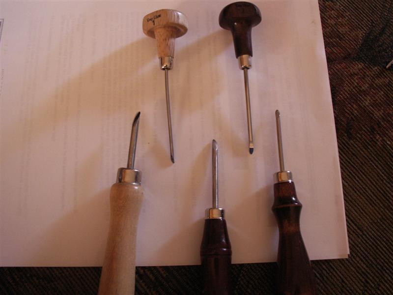

Hi John,
There are different things used to do lifting. The pro petal is being discussed in another thread here on the forum. There are also stamping tools that are called lifters. Here are a couple pictures that show some.
In the top picture, the top tool is a Craftool undercut beveler. The second is a Barry King petal lifter and the black tool is a Bob Beard version. Barry's tool kind of pushes up the leather making a ridge, where Bob's actually cuts deep into the leather and all the way into your marble underneath if you aren't careful. Doesn't seem to hurt the tool any and they are guaranteed. The Craftool version is sort of in between. It also has a more square face so it doesn't fit as well into the curved parts of leaves.
temp_051__Medium_.jpg This picture shows a bottom veiw of the tools.
Here is a picture of several different pro petal tools.temp_033__Medium_.jpg
Hope that helps.
Clay

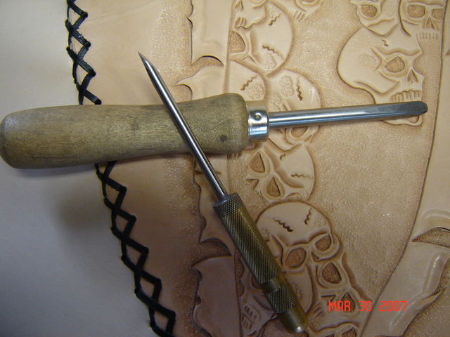

here are the ones i made. they are both made from stainless round stock. shaped on a sander then polished out on the bottom.
