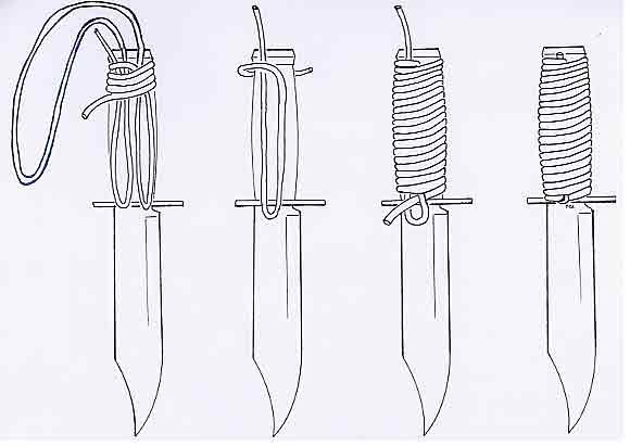

I don't know if you need this pict.

Wrapped handles work, but unless you can really secure the ends they come apart fairly easily.
I would try a pineapple knot. If they are done correctly the tension of the knot keeps it secure. Just my $0.02

Thanks Candyleather, that picture is actually really useful! I'm going to give that a try.
