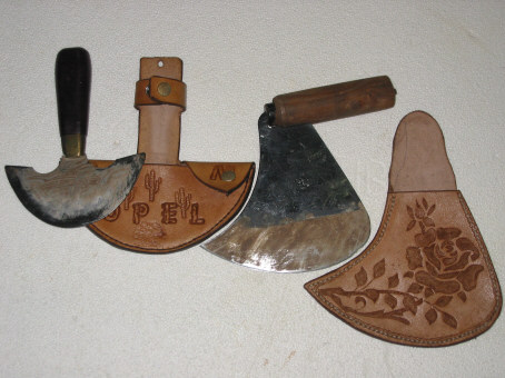

Members Brandon Posted July 29, 2007 Members Report Posted July 29, 2007 yes, thats it, the pizza cutting one, the round knife. Actually I was thinking it might be used similarly to a pizza cuter in that you could 'wobble' it down where you wanted to cut, can it do this? Also does it have to be on a flat cutting surface to cut normally with it? Ok, though I bot one a few years ago from Hidecrafter and Andy sharpened it for me before shipping, it was 'never' used! It is still very sharp, I only played with it with some scraps for a simple reason that my working space is too small. From what I've read and seen from videos, you cut them with the pointed edges most of the time and the 'middle' part is used for skiving or 'wobble' when you're coming to the cutting end or rounding a cut. Most cutting will be done on flat surface with the exception of trimming edges of certain projects. Many who had mastered it will use it to cut almost anything for slots to fringes. Sorry, that all I know. Attached is a pic of that round knife I bot from HC and the one on the right is one I bot locally before the shop went bust. I was told that the Hong Kong shoemakers used them. Both were coated with metal polish cos they're white elephants. B. Quote
