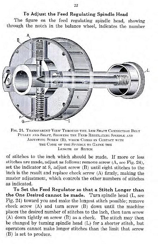

My 30's era machine, just gifted to me, sews 12 stitches/inch when the balance wheel dial is on 6.  Despite the diagrams on the W1,3,5 user's manual, there is only one adjustment screw port on the head.  When I removed the covering screw I encountered an adjustment screw with a screw driver slot so shallow that even a custom-made driver won't turn it.  I imagine I could drill the screw and back it out with a left-handed thread extractor drill but I'd like to know if there is an easier (sic) way.  Does anyone have experience with this problem?

Probably the stitch length regulator is gummed. Do you have a manual? There is a good X-ray picture in it showing the stitch length mechanism. W/O knowing details of your machine I would remove the  screw A + B and also pull out the spindle L. and drip in some mineral spirit (what ever you have, kerosene, paint thinner, white fuel...) and / or apply heat with a heat gun. But maybe the machine is just set to a shorter stitch length and you can readjust it - see picture & last paragraph  - hope this helps.
Hopefully the threading on the spindle knob or hand wheel are not busted.

aaaaah - sorry - seems I was too fast with reading - seems you figured it and you have a manual... sorry! :blush:
